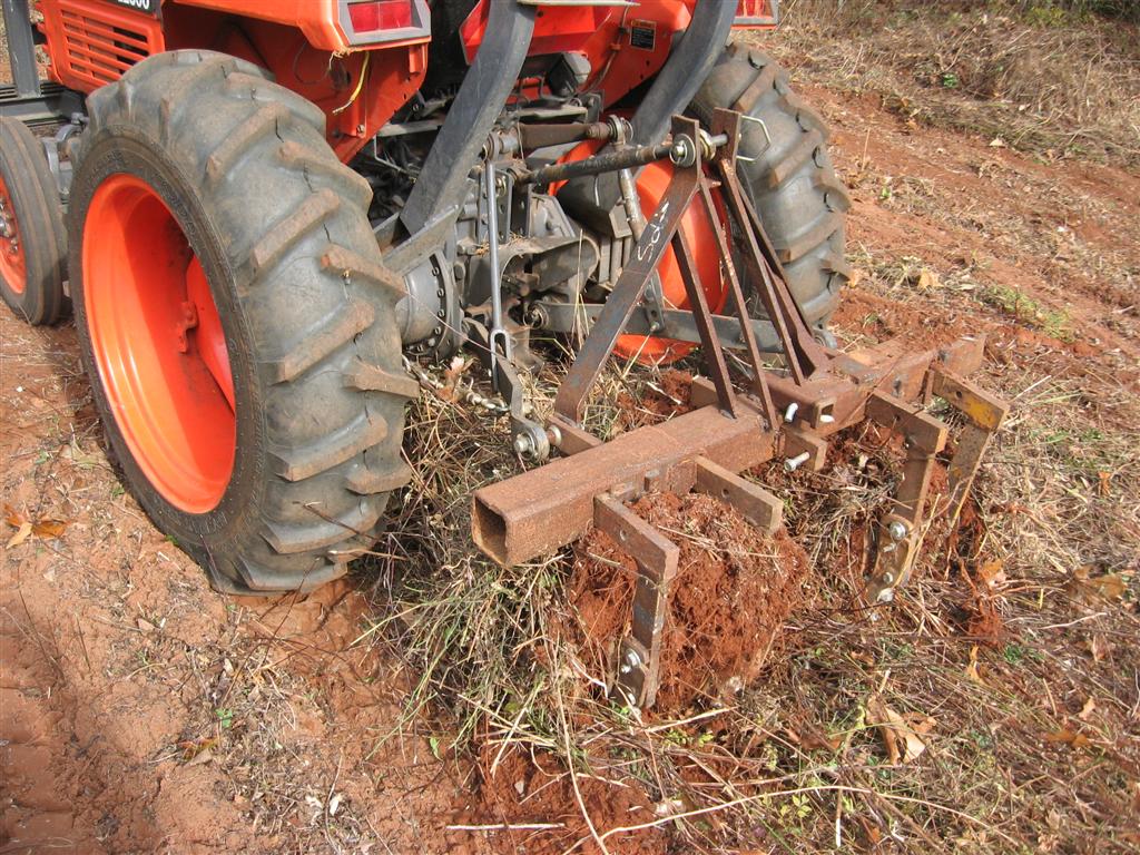

This little home made 5 chisel thing worked for me. I can remove a couple for more opening. I didn't have much of a problem with the dirt.
In the end, there will be some hand work. When we cleared the place for the house, it took 18 months for me to get all of the dead staubs that would pop out of the ground.
