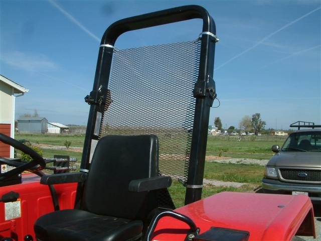

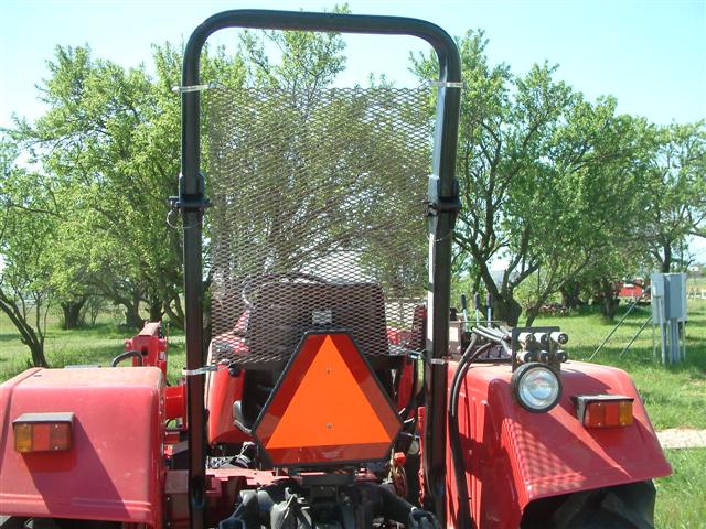

As far as must haves on the tractor: chain hooks on the FEL bucket; skid steer quick attach plate on the FEL; double or triple rear hydraulic remotes; a decent sunshade on the ROPS; a large tool box on the tractor (most come with tool boxes that are way too small). You'll also want to attach some protection to the ROPS to keep stuff from hitting you in the backside when you mow. Here's what I have on my 2008 Mahindra 5525
It's a piece of expanded metal from my local weld shop attached to the ROPS with hose clamps (you don't want to drill or weld on the ROPS since it's a safety device).
You can see the triple hydraulic remotes (flat top fenders are a big plus when installing these).

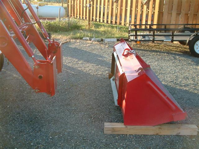

Here's what the skid steer quick attach plate looks like
This image also shows the chain hooks that the dealer welded to the FEL bucket. Two grab hooks on the ends and a D-type slip ring in the middle. The dealer welded 1/4" steel stiffener to the bucket and then welded the hooks to the stiffener.
