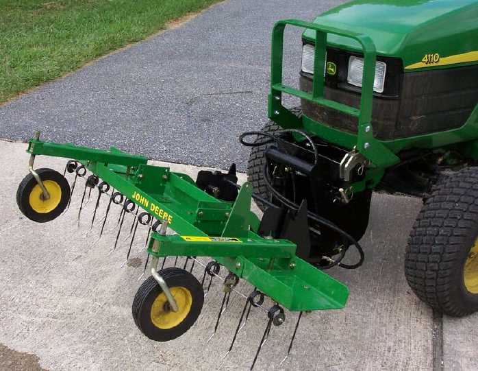

Tine dethtchers will work also. Both to prep the seed bed and incorporate the seed.
I spent less than $3 on nuts and bolts and customized an older front dethatcher from my late, great 445 JD garden tractor so it would work with my front hydraulics. Pic atttached.
