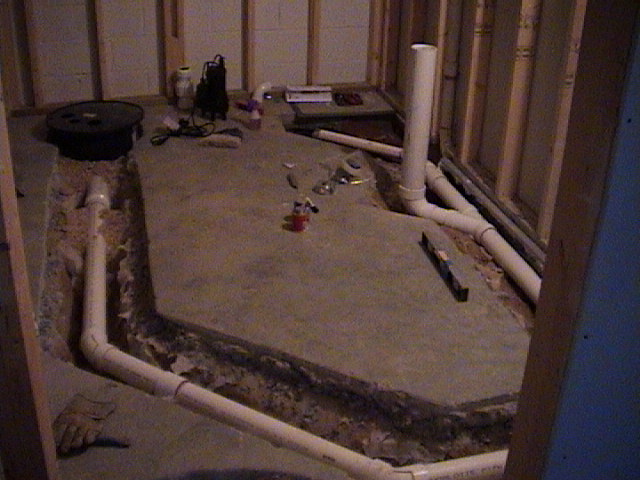

Well I got it done.....turned into a bit of a mini disaster. I ended up scoring the top about 1 1/2 inches deep with the masonry bit in the circular saw. That was a lot easier than I expected though I don't think the saw appreciated it too much. Then I rented a jack hammer from HD. I tried my best with the maul but it wasn't touching this stuff. Even the jack hammer wasn't going through it like I'd experienced when breaking up drives and walkways. I think this is the first time I've busted up that fiber reinforced cement. So I return the Jack Hammer and clean up which was no small job either. Now I cut the pipe that was pre plumbed under the floor which I want to tie into and re-direct to the basin. As I'm looking at it I wonder if my eyes are messing with me but it sure looks like the stub for the shower (up stream) is lower than the end I am going to tie into (down stream). I decided to pour some water in the toilet fitting and see what happened. Sure enough, all of the water ends up draining out of the shower pipe.......DOH!!!!!!! So now I have to head back to HD and rent the Jack Hammer again and buy another masonry blade so I can remove all of the pipes and completely reinstall them!!! All this because my moron builder decided, on his own, that I might want to put in a pool some day and moved the septic up the hill level with the first floor. Forget that the basement pre-plumbing was already set to have the septic on the basement level. Along with having a communicationally challenged builder it didn't help that we built this house from out of state and couldn't keep an eye on it like we usually do. I'm just sure glad it was pre-plumbed to save me some work not to mention the money! /forums/images/graemlins/tongue.gif

   / How to cut a concrete basement floor?
#15
Another pic.....
I suppose I could have re-plumbed it to go directly from the toilet to the basin but I didn't want to figure out how to change the venting.

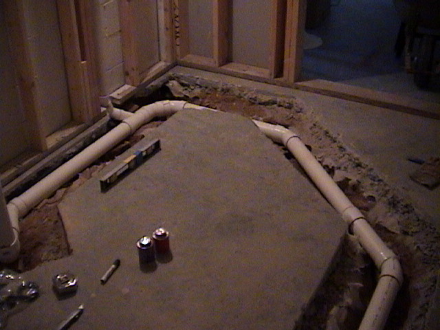

Here's a few more pictures of my progress. Pipes are back in and ready to bury. I'm going to get the cement today and hopefully have it in over the weekend.
