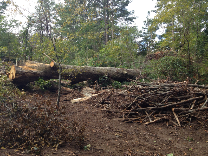

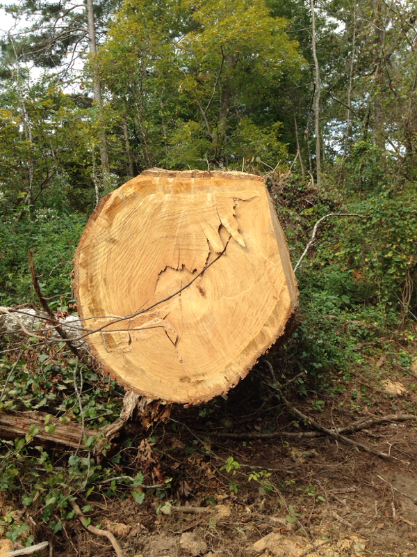

Here are the pics guys.
Looks reasonable accessible. Can you start from the sides and knock as much dirt as possible off of the root ball with your tractor FEL if you have one? Once you get most of the dirt off of that, it is much less likely to want to fall back into the hole. Especially if you push the dirt back into the hole after you knock it off of the root ball. If it is close enough to the house you might be able to use a long hose and water to knock a lot of the dirt off too. A sawzall on a pole will let you separate some of the roots that are trying to pull it back into the hole too.
Not saying this solves all of your problems, but it would get some of the pressure off of the tree if you do decide to cut it up.

Thanks for the pics buty. I agree access doesn't look too bad but it's hard to tell slopes etc from pics. Did you say there was a slope? Did the tree fall uphill? I don't know what oaks are like for furniture wood etc up there but normally oaks are good right? And that tree looks like it would make some decent slabs. Now I haven't done a whole lot of milling - I have a double header Alaskan chainsaw mill that my dad converted to hydraulic drive driven through hoses from a Subaru powered power pack and I have started collecting all the parts for a bandsaw mill like a wood mizer which is on my bucket list - I also have 9 saws as I said (plus 4 dozers that don't quite go yet :D) and have a fair amount of experience with trees (got taught by an old timer before I was 10) - so yeah, I have got the gear and some know how and would sure have a go at that tree and turn it into something good.
Some ideas - 1st thing, clean up a decent area all around and under that tree (even the pile of branches looks a little close, you can burn most of that though but keep some larger logs to use around the big log). Then get some more photers of the rootball and the hole. The aim after that is to take the pressures off each end so an idea may be to get some notched logs parked under the tree then I would suggest getting a bloke that is tree wise with a big saw to give you a hand to top and tail it (could be a little tricky - will want to be planned) - if that bloke has a portable mill as well it all could work out well. How is access to the site though? Oh yeah, one idea for the rootball could be to lay a few logs across the hole so if it flops back into the hole it will stay up out of the hole and when the dirt washes off it will fill the hole OR if you knock off the dirt first you can fill the hole with sticks and light a fire when the stump comes back on top?

Using your FEL you might be able to lift it back upright with the ball pulling it back into the hole.?. You can also cut a chunk out of the trunk near the base I am betting it might be hollow. Starting to rot and die from the inside out ground up. If so its possible with the shorter bar.

   / How to cut a large tree trunk? #38
First I would do a test cut to determine it it is hollow. If it you are on easy street. Cut the top quarter of the diameter. Then you should be able to reach from the ground to cut each side keeping in mind the potential for spring action.
If it is not hollow: You can get-r-done with a 20" bar, it will just take a couple of steps. Going from the top to the bottom cut 2 parallel cuts 12" apart on each side of the trunk, you then use boring cuts to remove the wood between the cuts. This will provide you space to reach your saw further into the trunk allowing you to cut all the way through the trunk. As you are cutting always have a firm 2 handed grip on your saw so you will be ready for a sudden jumping if the potential for springing/ snapping of the trunk should occur.

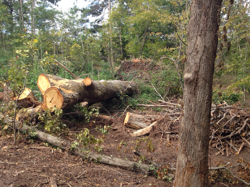

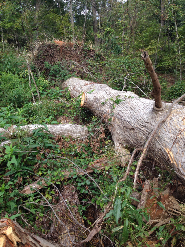

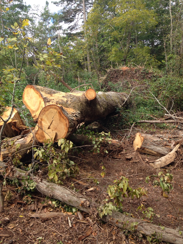

#40
Just wanted to make an update. Thanks again for all the replies. I listed the trunk on craigslist for free firewood and it turns out a lot of people actually wanted it. After speaking with a few of the gentlemen, I agreed to let get one guy come and cut some of it. Since I could load it for them with my FEL, it was a little easier for him. He had a 24 inch saw that he just started on the end making slabs. So far so good he's managed to cut out about half of the trunk and it's still hanging about 5 feet off the ground. This person has his fill of wood so I am waiting for the next person to come and cut some. I believe the rest will be fairly safe and easy judging by the first half. The the rootball has fallen into the hole and appears to be holding very firmly.
