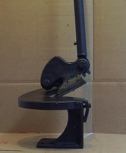

I've been thinking about your problem. What about a hot knife? Back in the day we used to groove tires with a hot knife and if you were not careful you could cut through the cords of the tire. Or maybe something like the hot metal bar that the box stores have to cut nylon rope. I would be a smoky job but it might work. I just don't know if the hot knives have enough umph to cut 3/4" inch belt. In my last post I also mentioned a throatless shear. Would something like this work? It would be portable. Good Luck SimS
