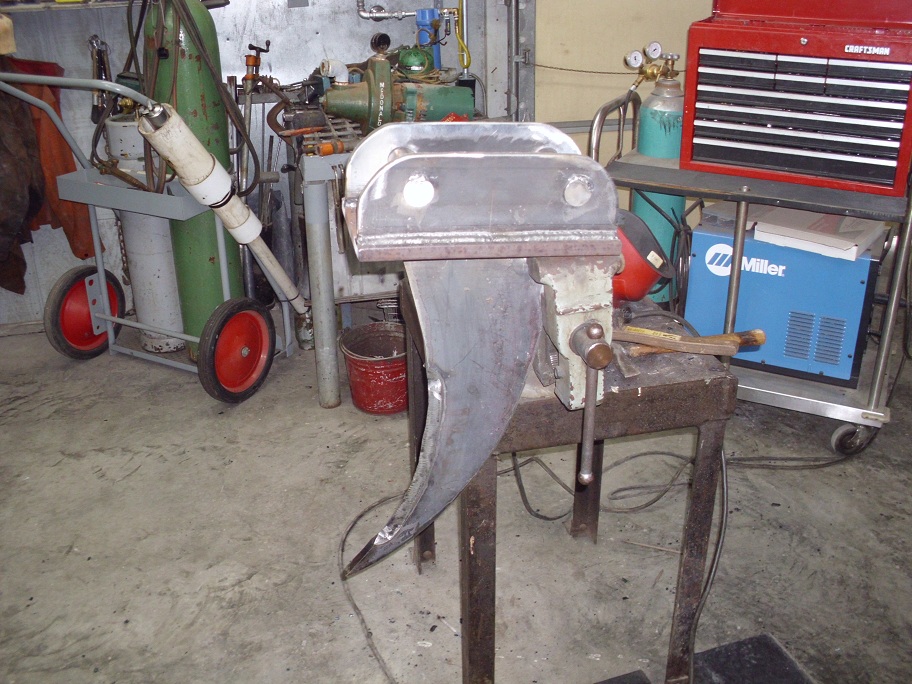

I once had a manufacturers website on my favorites list who made a sharp edged ripper attachment for backhoe buckets (the link is gone - victim of crashosis). The stump I started digging today has some roots 3-4" in diameter 24" out from the stump, and although I'd eventually get it done, digging this one this is hard on my machine. Does anyone know of a product that mounts to a backhoe bucket, dipper stick, or even the 3-pt. for cutting through roots? TSC has a subsoiler for about $160 that I guess I could sharpen, but I'm not sure it would work.
You could make yourself a ripper out of T1 steel. You would cut in the teeth like a regular wood saw. It would be pointed, and when you drove it in the ground by the root, you apply an up and down action using the backhoe, and it should saw through the roots.

I have the same problem dealing with recently felling white oak tree stumps. The roots which are four to six inches in diameter, are too much for my 32 HP Cub Cadet Yanmar EX3200 TLB. Evidently the tensile strenght of the roots exceed the breakout force of my backhoe. I was thinking about using an angle grinder to cut a "toothed" edge on the edges of my backhoe bucket. The objective would be to allow the toothed edge to "saw" through the root fibers. My only concern would be that the bucket might crack at the inside corners of the grinder cuts when put under a high stress strain load?
   / How to cut through BIG tree roots? #45
Better to start a new thread. This one is almost four years old.
Having said that, consider getting a ripper for your backhoe. Search ripper and Island Tractor and you will find a long discussion of said device from last fall.

I made this for my miniexcavator. It turns it into a real powerhouse. It will rip roots like a big boy. The best part of it all, is that it doesn't disturb the ground near as bad as a bucket and can cut much bigger roots. Some times you have to chip at the bigger ones but it hasn't failed me yet. It works really well on frozen ground also.
