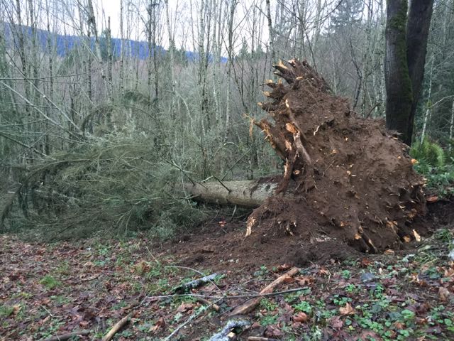

We had a big windstorm and have a number of large trees down, all pulled up by the rootball. My concern on all of them is snapback with the rootball. My neighbor has some sort of specialty certification in tree removal (he works for the government managing large tracts of land) so hopefully he can help, but with the holidays he may not be avail.
Anyway, just wondering how you would tackle this. Oh, rootball is around 10 foot from the ground up. Photos do not give the thing justice.

That tree stump doesn't look like it is going fall back into the hole when it gets cut but may roll toward the trunk or side to side. Since you have a tractor and the tree is on a downslope, chain the top of the root ball from the upside of the slope to your tracker and put the chain on a bit of tension. Then I suggest plunge cutting the middle to the bottom leaving a trigger on top so my saw cannot bind.
Practice plunge cutting after watching some YouTube videos as it is an essential saw-handling skill. This issue of plunge-cutting is to start on the bottom front part of the chain and then roll the tip into the cut and allow the saw to cut itself in. You must understand how the saw handles because if you don't understand how to plunge cut, the saw tip will kick back and potentially cut the operator.
When you make a plunge cut , you cut through most of the trunk from middle to bottom in this case, leaving a bit of material on top. The material on top is the trigger. Nothing will happen until you cut the trigger from the top down in a second cut.
If the root ball rolls back into the hole, no big deal. If the root ball rolls side to side, you are prepared to get out of the way. If the root ball tries to roll toward the trunk down your slope, your chain prevents that from happening.

My method would be to buck the trunk back to five feet of the stump. Use the tractor to stand the stump up then make the final cuts. This way you will be in control of the stump all the way.

That one looks simple, nothing to worry about there. Personally, I start at the top and work "down". The cut at the base is the last thing I do. That way if anything is going to move, it's going to do it a little at a time as the weight is reduced.

Hook a chain to the root ball so it can't fall toward the tree and use a chainsaw. It will let you know when it is going to flip back and you can just get out of the way. I have done many and it is not as bad as it looks. Ed

This is a huge root ball leaning pretty good down hill, and he doesn't have a very big tractor. Changing the root ball to the tractor = bad idea. I would chain the root ball to another large tree up the hill.

Me, besides probably letting it lay 'cuz I have lots of Beech and Sugar maple to burn and let it rot in place, would tackle the root ball thing at the get go. From the uphill side, cut upwards about 1/3rd of the way thru the trunk somewhere handy. Then cut from the top down towards the 1st cut. You should see real soon if the root ball wants to settle back down or not, and if the trunk is going to want to roll downhill some. Finish that cut, either downward or upward [using wedges if you have to], and get the thing separated. Then start limbing the rest, again from the uphill side and making sure it doesn't want to roll either way. Buck up the trunk and split in place... But, heh, that's just me.....

Put some blocks under the trunk near the base and then use a bottle jack to lift it a touch. Cut on the stump side of the jack. If the bar wants to hang up just jack up a little more. After the stump is free do the limbing as the branches let you. Finally cut into lengths and place on blocks to get the log off the ground.

I would secure the root ball, drive a shim under the log back near the root to hold the log, then cut it off right at the shim. That should prevent it from pinching the saw.

Cut it just like you would a low branch. Up from below about 1/3 then down from the top. If the root ball wants to pinch, you'll see it when the holding wood gets thin. You can wedge from above then as needed. If it's going to fall back into the hole, it'll start pulling away and closing the bottom kerf.
Eric's plunging isn't a bad idea to start the bottom cut, but I'd rather take the tension out of it than cutting a trigger as the last move before seeing what it wants to do.
If you want the root ball gone, put some blocking in the crater before you start working on the trunk. Makes getting a grapple on it easier (or sticking your bucket under it, if that's what you've got).

IF you've got the bar, the time and the desire for wood this reads like a good approach but I would not mill from "the top".
IF that rootball is 10 feet high it looks like the tree is < 2 foot DBH.
Then looking at this pic
451405d1450889603-how-cut-up-fallen-tree-img_1536-jpg
it seems like you could roll the tree downhill to the LEFT.
I would fasten a strong rope towards the top of the rootball and to something to the uphill RIGHT of the stump to prevent it from rolling.
I'd limb it "leave the trunk and ground support branches intact." then measure off some good sections and use the downhill slant to CSM three 3 inch thick 10' or longer slabs starting several feet from the base and working downward (don't make them to thick or long, they will be to heavy to handle). Gravity will help pull your saw. If you enough length of good wood for another set of slabs I would then repeat for another 10' or 12' section. Basically cutting the tree in half. I only write 3" thick slabs because that's the size I like.
Next carefully cut some or most of the ground support branches on the LEFT side, using the rope to ensure it does not roll.
Then "top" the tree at the downhill end of your CSM work.
Take the rope and USING A SNATCH BLOCK (for safety) pull the rootball and tree over to the left, continue your CSM work.
If it won't roll to the left, try to the right.
