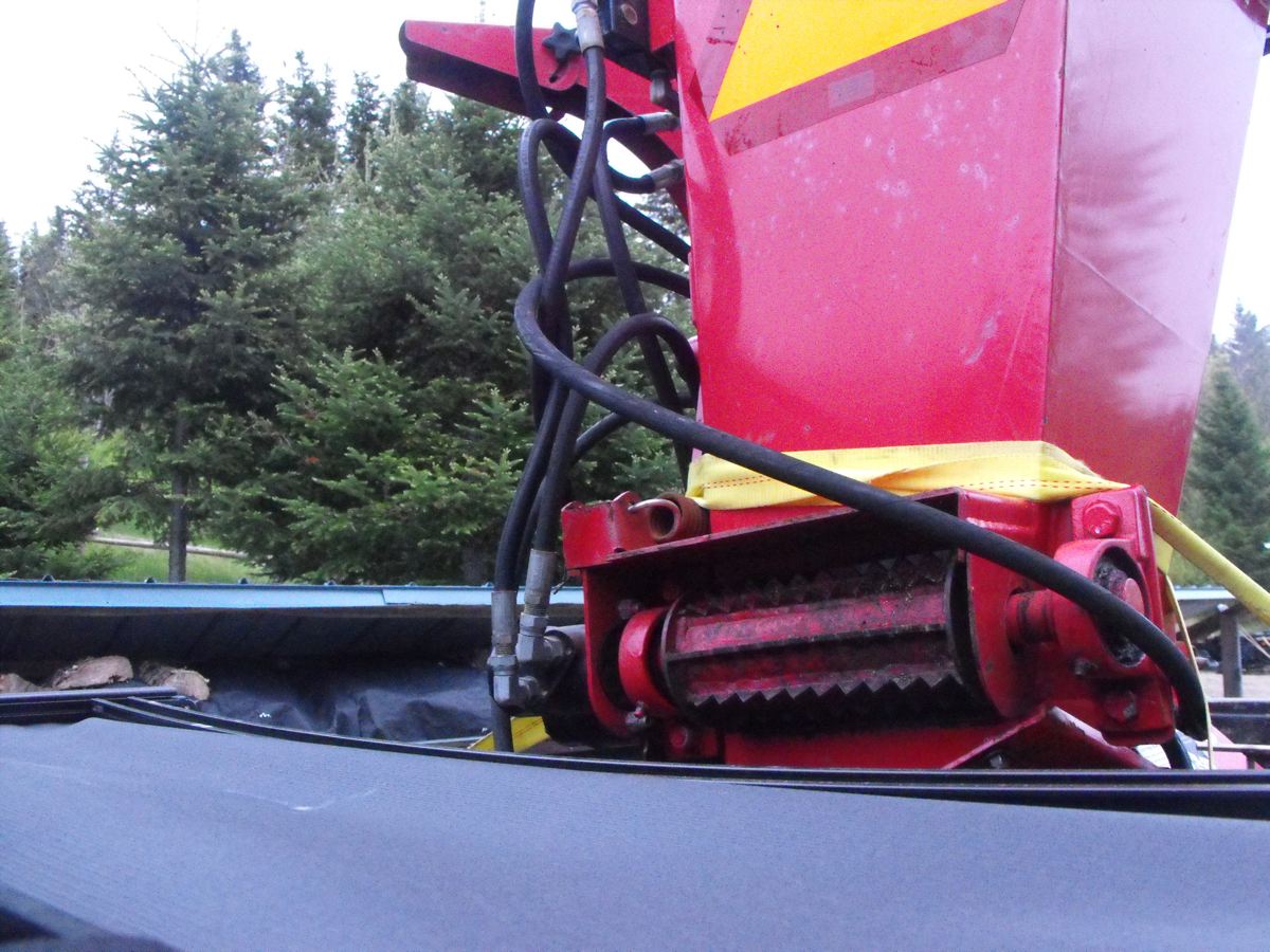

I picked up this yesterday. First time owning one, and still a newbie with anything hydraulic. I had the seller run the chipper first and it performed ok. But I noticed the fluid dripping out of his remotes when he disconnected was a muddy brown/coffee and cream sort of color. So I am guessing there's water in it? I quick call to my local dealer says I should drain it and its as simply as pushing the pin on one of the hoses. That simple? I'm thinking that all of those gear housings would want to drain out too?
What's the best way to tackle this as a DIY? Thanks for any help.

I would take the fitting/QD off the return hose and place in a bucket and connect the pressure up and run the chipper for about 10 or 15 secs.
When the fluid looks the same as in your tractor, should be good enough.
Replenish the fluid in your tractor.

In the bottom of your picture there is a hydraulic motor to run the toothed cylinder. I can tell what else the hoses go to from the angle of your pictures.
It's possible you have another hydraulic motor on roller higher up, just can't tell from the pictures, wrong angle.
