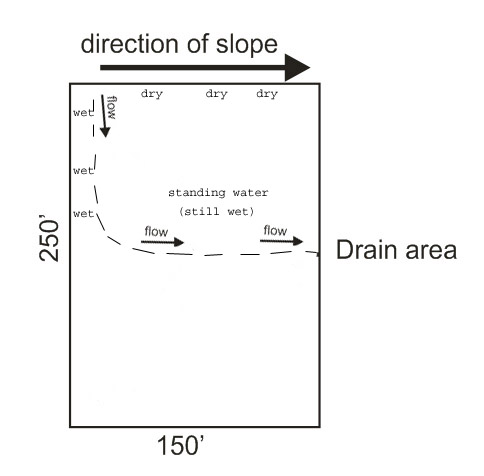

#12
OK guys, thanks for the input. I received my Howse Middlebuster today from Northern Tool. Although it seems to be a little too long, I think I can get it to work with my B7500. I'm going to make some trenches this weekend (per my diagram) and see how things drain. If it looks good and the field dries up, I can plan on widening the trenches and burying pipe this summer when everything is dry.

   / How to drain out a wet field?
#16
UPDATE:
I made a small trench with my middle buster (~4-6" deep x 12" wide) in a little different layout than my original plan. I was afraid to go too deep on the first pass because of how wet it was (didn't want to get the 'bota stuck). If you look at the attached drawing, I stayed high on the property and tried to catch all the water before it makes it's way into the field. Well, water started flowing almost immediately after I made the shallow trench. I pretty much had created a small stream from the high end of my property then directed it to the low end. I thought that my troubles might be over when I saw all the water flowing, but soon realized that there is water coming up in other areas of my property that are lower in elevation than the trench. Ground water must be flowing under the trench, and up through the ground in the middle of the field. My thought is that I need to go deeper. Does this make sense? My next move is to make another pass with the middle buster and see if I can get down another 6-8". If that doesn't do it, I have access to an excavator but would want to be sure that I was on the right track before I begin a project like that.

   / How to drain out a wet field? #17
Give it a few days to drain and then reassess what needs to be done. I have the same problem and am still working on a resolution. Once I have one area dry, it seems that another area is still wet and not draining like I though it would. I just keep attacking it a little at a time until it is all resolved. It is just that every time it finally gets dry enough to work the area, the next day it rains.
#18
Junkman,
I should have mentioned that it's been 10 days since I dug the trench.
The water has been flowing through the trench the entire time, but the field looks the same. It really hasn't made any difference as far as I can see.
   / How to drain out a wet field? #19
Wow, sounds like lots of water. Worth setting in a deep drain tile with laterals into the field. If you can make a single open ditch work, then you are money ahead but if you must go deep and with a bunch of finger ditches then you really start chopping up your land.
