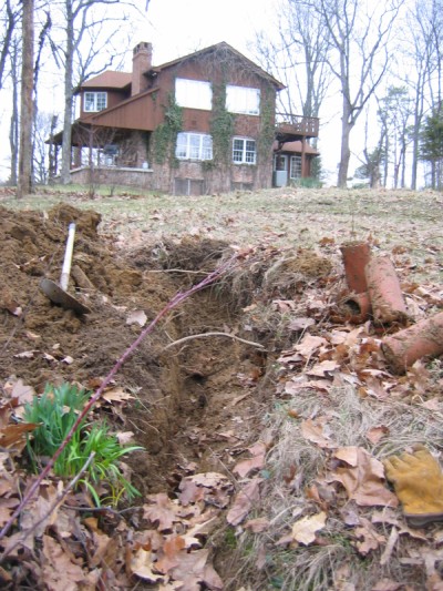

Here is some more information. The original part of the house was built around 1960. At that time, a drain was put in and it dumps over the hill. The ground here is clay on top of sandstone. They hit sandstone in the basement and the drain tile doesn't have a great deal of slope, because they didn't want to cut through the stone. The basement was/is finished living space. The drain was used for a basement shower, washer and utility sink for may years. Ten years ago, we remodeled and put a second story on. I also plumbed the sink and washer into an above floor tank, with a sump pump to dump the water well away from the house. So the drain has not been used for anything but carrying off ground water since.
The house has had three additions added. The front porch, a back family room and a guest room addtion. So three sides of the orginial foundation is covered by structure. Digging out the old tile on those three sides is not an option.
You may be able to see in the picture that the field tile is almost completely blocked with soil. I could still get a snake through the pipe, but I'm sure it is blocked near the house, with water backing up in the pipe and seaping in along the floor edge. There is indoor/outdoor carpet down there and it wicks pretty well. I've been sucking water with a shop vac.
To add to the excitement, my late father-in-law owned part interest in a cement block plant when the house was built. I'm sue the basement floor is extra thick. I'm only around on the weekend and don't know if I could do this by myself. I'd be happy to do some, but I'm pretty sure I'm going to have to hire some help.

I'm thinking we are mixing the drains here. Showers and such go to a septic field. The drain that I thought you were having trouble with was your "outside", ie, perimeter drain. hence, talking about digging up around your house. Is your sewer backing up? Or is water seeping in through your bacement walls?
In any case, you will not need to remove your bacement floor. If you have drains under your floor that are cloged, they will need to be reamed/cleaned out.
Patrick T

No, my FIL was ahead of his time, putting gray water striaght into the field. The septic is fine. We have had record rains and the ground is soaked. There are no floor drains, just the field tile around the the original house.
I'm thinking I'll need to put a drain system inside the basement, digging a trench along the basement walls, dumping into a sump pit.

Grey water systems are fine, just not tied with your bacement drainage.
You have likely destroyed the perimeter drain with soap scum, lint

Knowing what we know about your situation I don't think you have any other choice but to go with the sub-floor drainage system, which would be my first choice, but as you can see others believe as strongly in the exterior system.
You still need a sump pit for a junction, but might not need a pump if the side of your house that is on the down hill side is accessible (no additions, porches etc) use your back hoe to dig a trench to the area where the existing drain came to daylight, always better to drain by gravity than rely on a pump/electricity.
If you go with the gravity trench, use solid pipe out side and you can tie your leader pipes/surface drains into the same trench, just not the same pipe, you want to keep them separated and the outside drains don't have to be that deep in the ground as the one coming out from under the basement floor, keep a narrow trench and the outside drain can go on top of the basement drain.
You do need a little pitch to prevent sediment build up, but it's gonna happen anyway due to the slow passive movement of the water from under the house, that's why you need the junction pit so you can flush test/clean it from inside. you don't have to get carried away with the pitch, even 1-2 % is fine, but at no point can the pipe have a hump in it that is above the floor level in the basement and as the pipe gets in the frost zone you don't want any dips either, to prevent freezing. you want to set the discharge line so that the level of water under the floor is a min of 6-8 inches.
A simple way to check all these specs is when the trench is open before any pipe is put in, test it with water in the bottom of the trenches (inside and out), the bottom of the trench should be the exact contour you need and then any piping (outside) will be solid so you don't need any stone or filter fabric just lay the pipe on the bottom and back fill with dirt.
