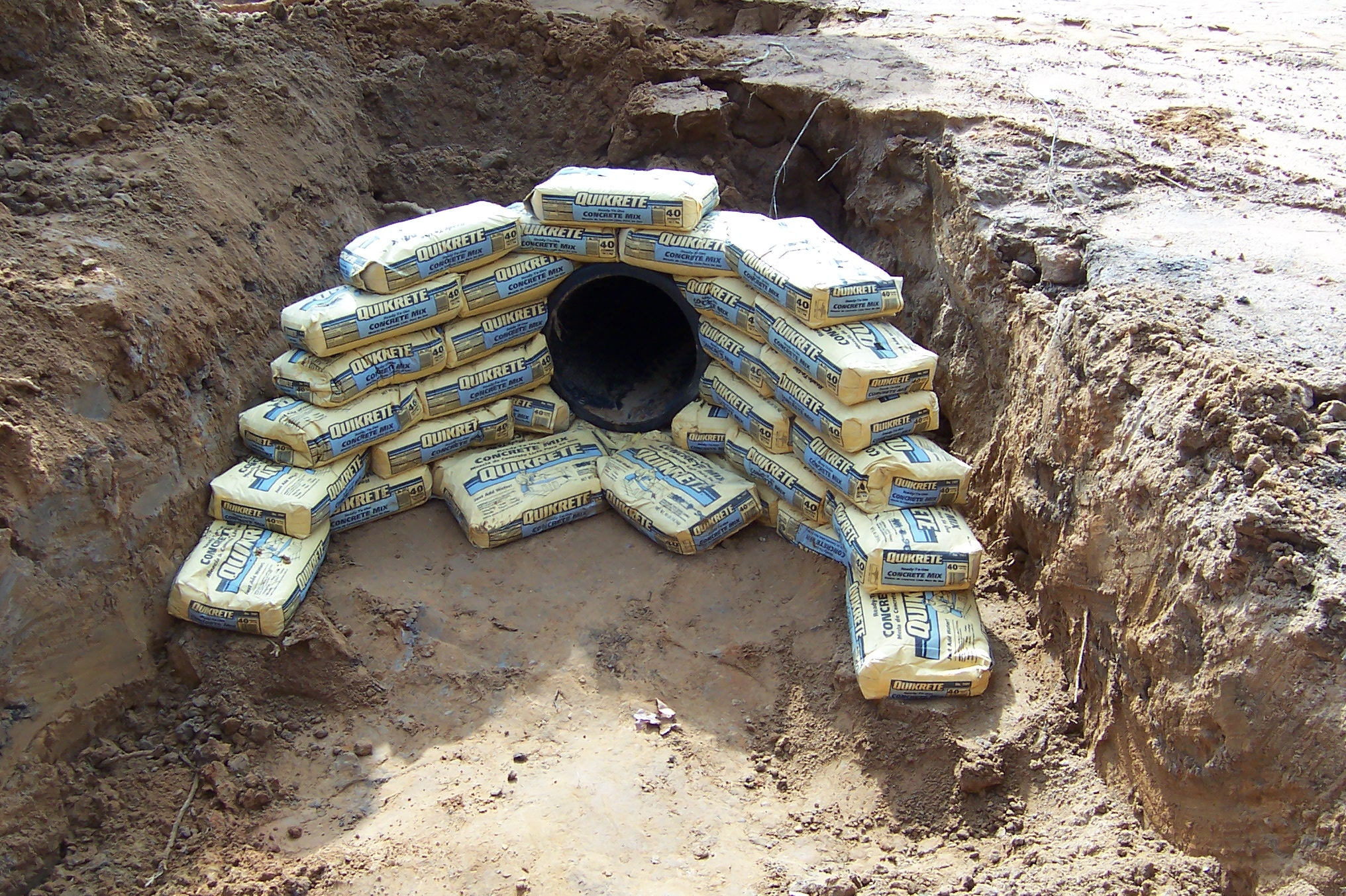

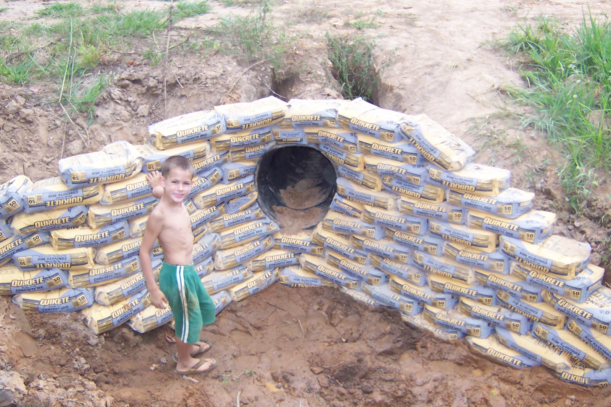

If it was my place, I would stack sacks of concrete to build up a wall to support the trail. While the sacks are still dry, pound rebar through them to lock them all together. Also pound the rebar into the soil that the sacks are sitting on. Bigger rebar into the soil would be better.
Here is an example of what I did for a culvert for my pond. I've seen the same thing done on a lot bigger scale.
After building it up, I would fill behind the sacks with gravel so water can drain easier and not build up behind the sacks.

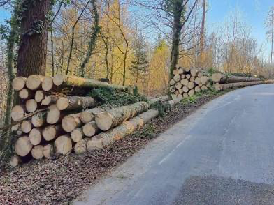

Depending on how good you are with a chain saw… start dropping trees along that edge drag them in place with tractor. The longer /more the better. Stack them up like cord wood. Until that side is higher then mountain side then fill with dirt and rocks and get some vegetation growing on it. Then ditch the other side so the water runs past that point. And water bar along the trail. Start kind like this.

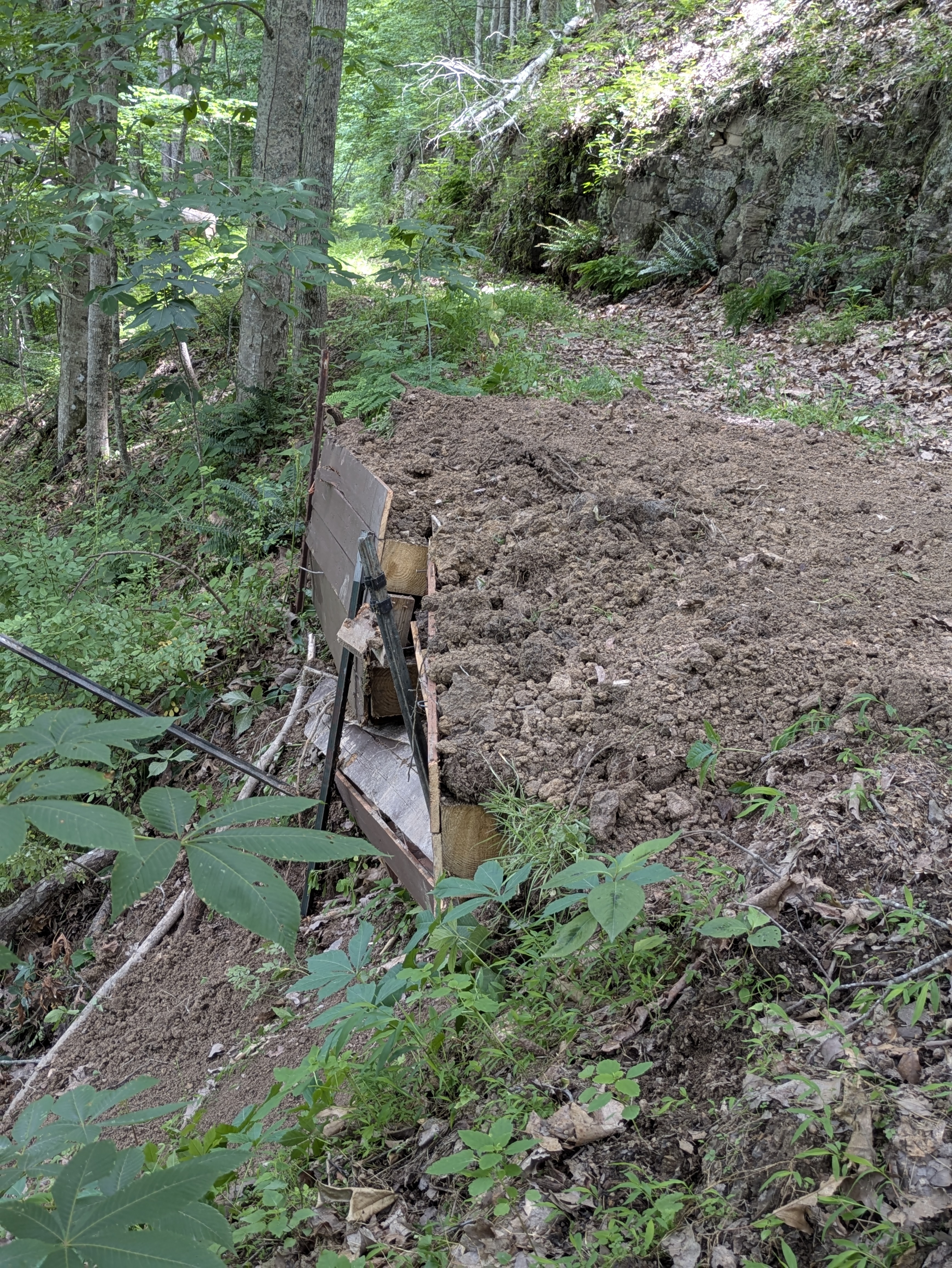

I've got a trail that runs up the side of my mountain. It's badly eroded in one spot, I wanted to fill it in before it makes the trail impassable. It's washed out on the downslope side, and it's extremely steep. Not sure if I'd even be able to get up it on foot. View attachment 3682140

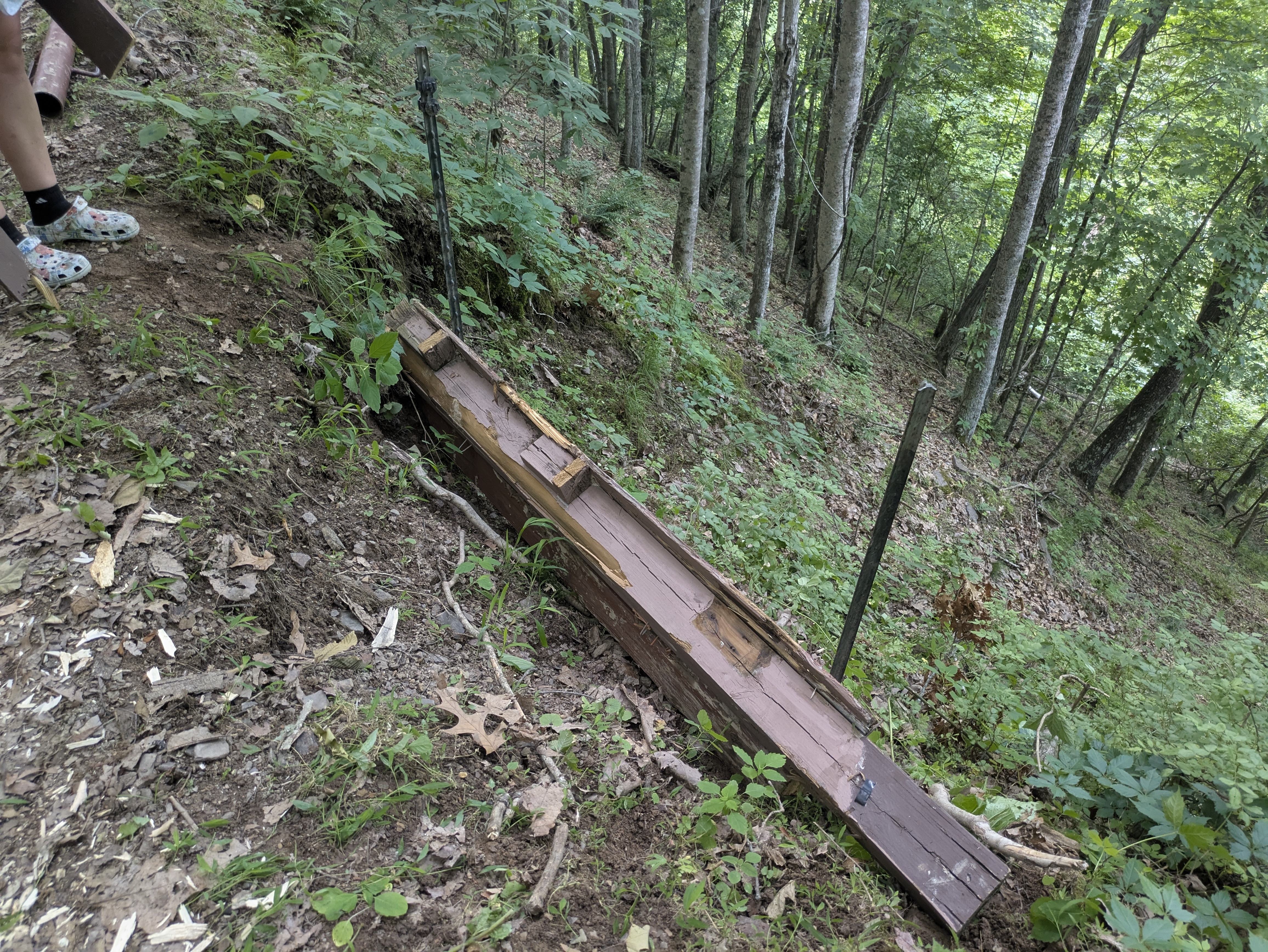

Initially I drove 4 metal t posts into the side of the mountain, parallel to the trail. I had some 6x6 fence posts from a fence I'd taken down, so I laid them down against the t posts. Then filled the whole thing in with dirt.
(The one t post at a wonky angle was too bent to drive in properly, but it's too steep to get down and pull it back out so I just left it. Not really doing anything to support the posts)

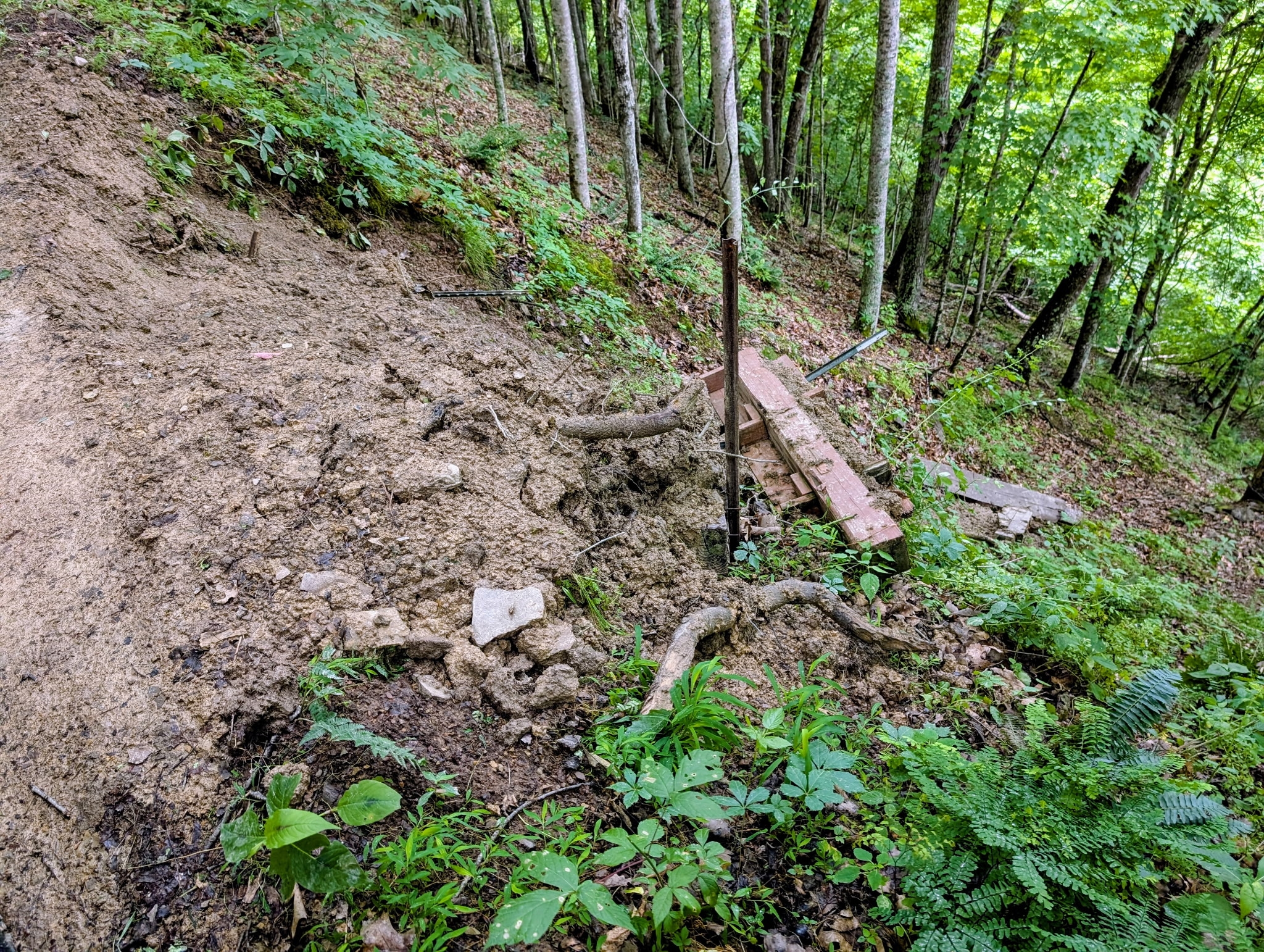

It looked great for about 4 days, when a heavy thunderstorm rolled through and the t posts failed. View attachment 3682144
My next attempt I'm thinking of increasing the amount of t posts, and then using rocks to fill in the bulk of the space with dirt added as a filler. The thinking is less diet to hold water means less weight for the bulwark to support. Does anyone have any better ideas or suggestions on how to build this before I go rappelling down the mountain to get the posts that washed out?
