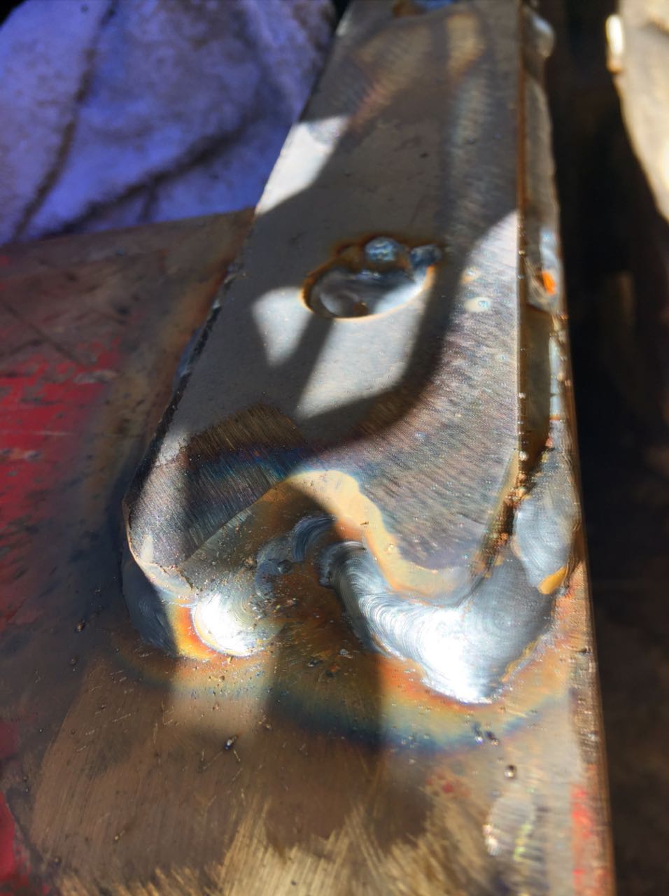

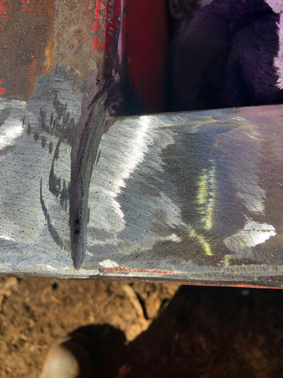

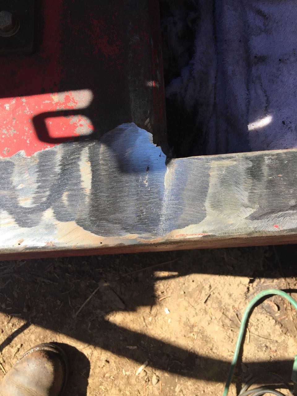

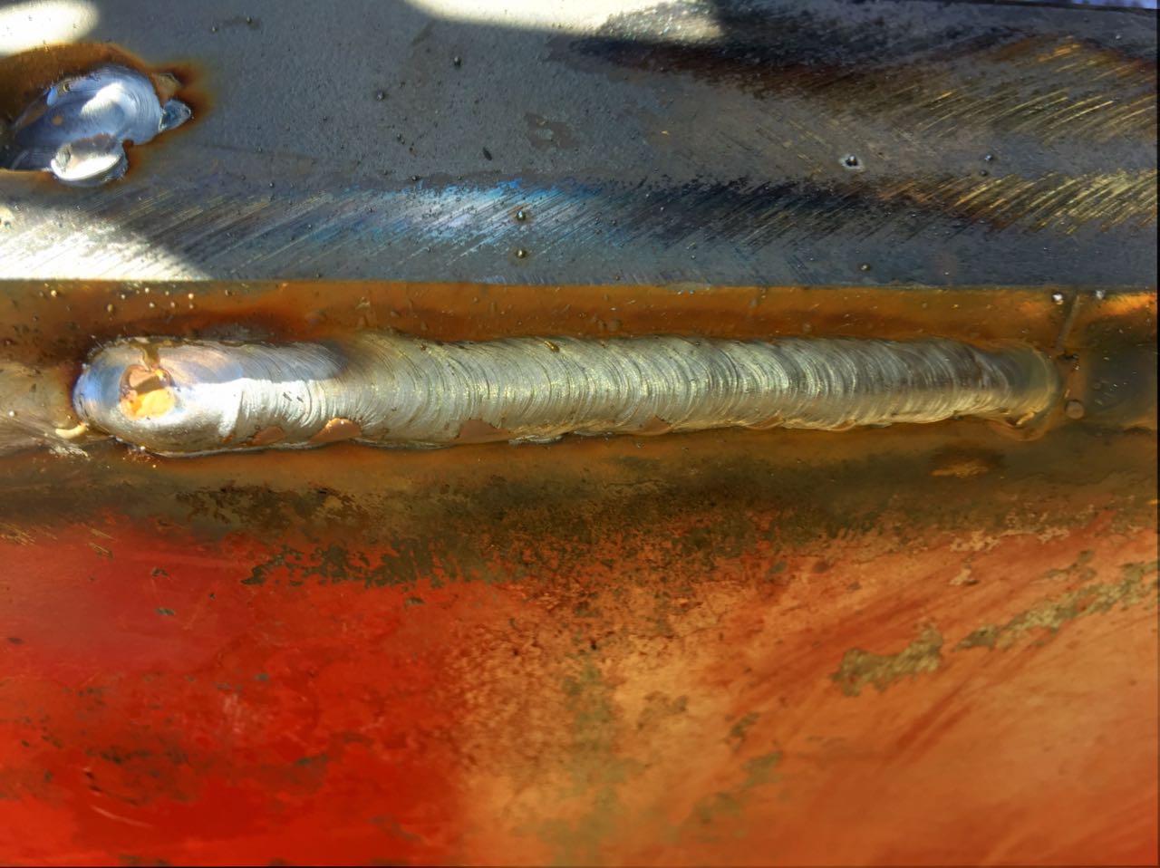

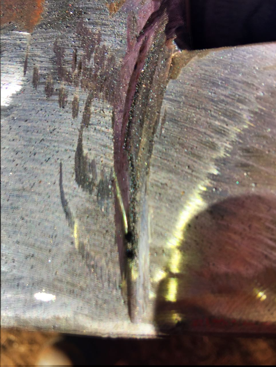

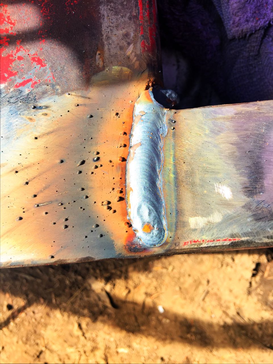

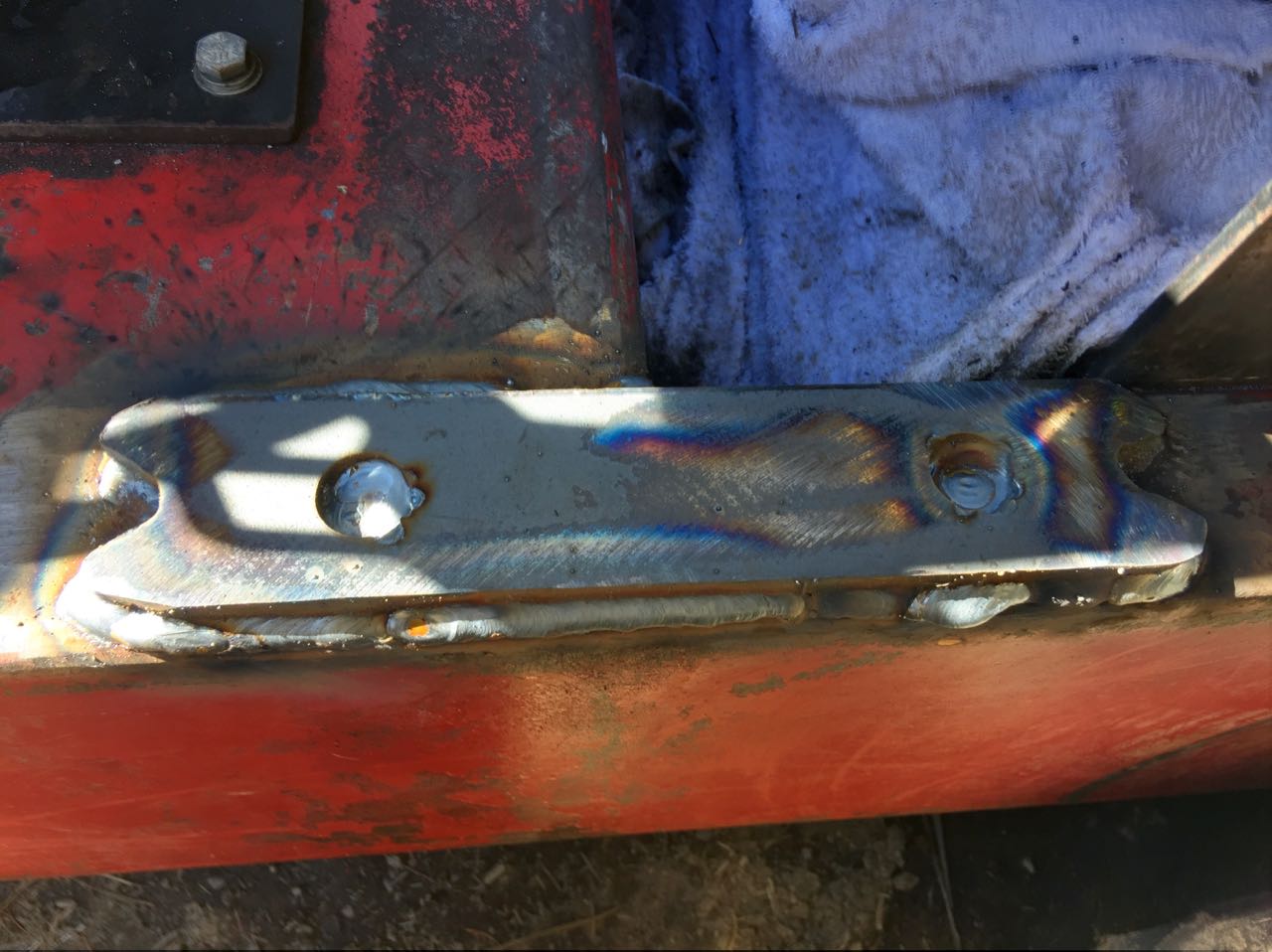

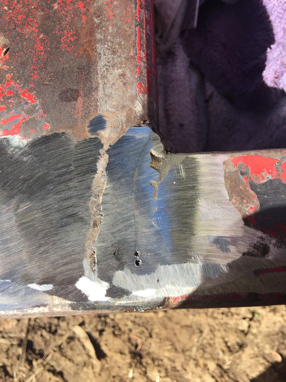

OK guys - I am halfway through (or maybe done - lets see what you all say).
I found a piece of 1/2" stock that fit perfectly. A bit thicker than I wanted. I did a layout with the fishplate template and it looked good with the marker. But, I have a lot to learn with my Plasma Cutter and it was wonky as a mo fo. Need to learn that when you are cutting cornere you have to be straight up and town, an angle of any sort just does damage
At this point I put some Co2 into the oil tank. Ran a bit of gas from my mig into it to help alleviate any heat worries.
So next I drilled a relief hole and then ground down the crack. The first picture is grinding it flat. THe second picture is grinding into the metal. You will notice two drill holes. Thought I had found the end of the crack but when I ground I found I was off a bit. I then hit the whole thing with a torch. Heated the area up, Hopefully burning out all the oil in the crack.
Flat Grinding
Gouging
Before the torch and cleaning

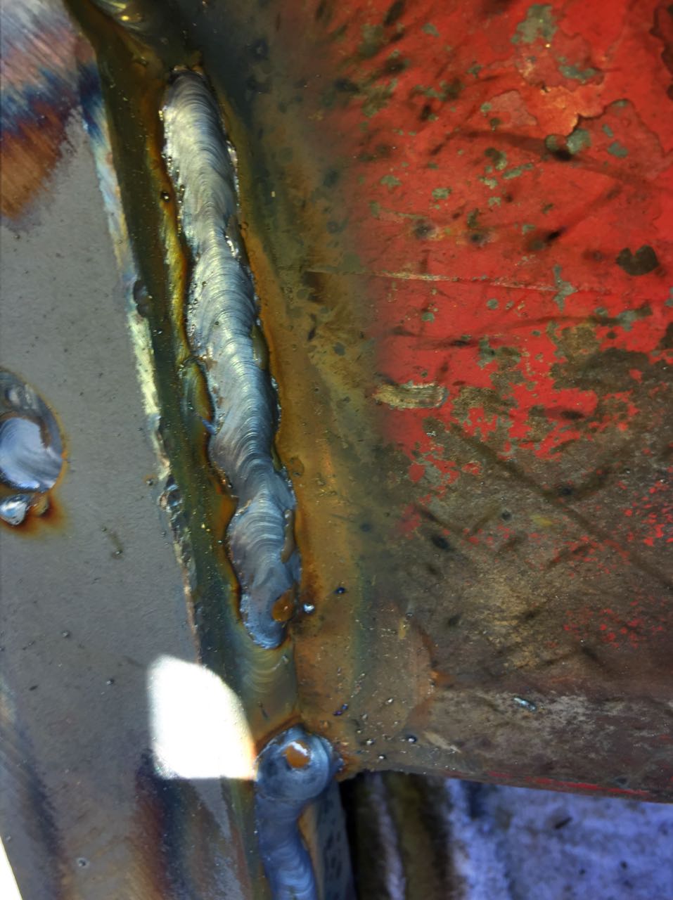

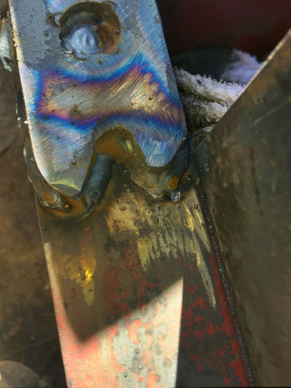

So then I put the Fish Plate down and started welding. I used my Lincoln 180C for this layer of weld. Set the voltage almost all the way and wire feed at 2/3rd. I have found this setting gives me nice penetration but doesn't dump a ton of metal. I welded at 2" at a time per my neigbors instructions. I find this very difficult as I get my mojo going and then when I start again I blow it.
The Weld
The grind after the weld
Fish Plate and Details
So here is my question. Should I do another pass. I am not sure what it gains me but that is because I am an inexperienced welder. On the verticles do I do a strand on either side of the weld tying in the current weld (making the weld wider?) Going to take a lunch break and would love to here your thoughts
   / How to fix this crack #79
It would not hurt to put another right beside it.
   / How to fix this crack #80
I would not have run the plate that way. I would have run a triangular plate across the two corners. A right triangle to bridge both sides together. It's a type of fish plate, but the way the joint is, it doesn't do a lot of good to have a long one that really only reinforces both sides. I don't think you've gained much strength or bend resistance running it that way. I could be wrong though. Don't forget to redo the inside vertical weld. There will be problems there too.
