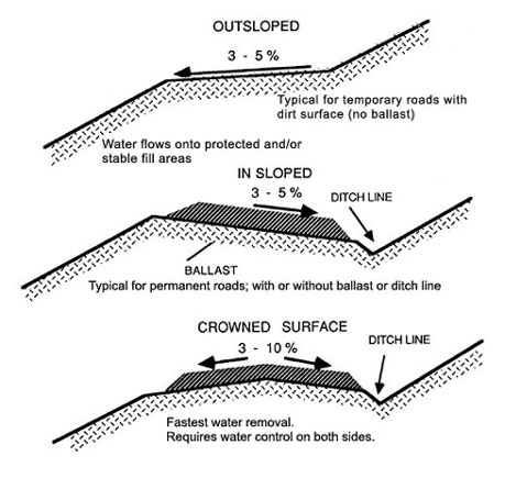

It looks like a long driveway on a hillside. I wouldn't crown it, or put in an uphill-side ditch, unless there is surface flow from the hillside. Make it flat and sloped to the outside 3-4 inches.
A long hillside ditch will collect lots of water, form small dams, and then flood and wash out onto the road. That's what happens on the "public" gravel road on a hillside I use.
I have a 6-8% slope gravel driveway on a hillside, made with a side slope like the top diagram. Not a trace of washing after 5 years of 40-60 inches of rain a year. I do keep it from forming tire ruts that can run water down the road.

This looks like good advice. The best advice I ever got is "water's going to go where water wants to go". Gravity always wins. The best you can do is divert it, redirect it or slow it down. To me that means get it off the road bed (either with a gentle side slope or crown). Do not let it run down the road and pick up velocity.
Basically make it better, watch how that works, and make it better again.
