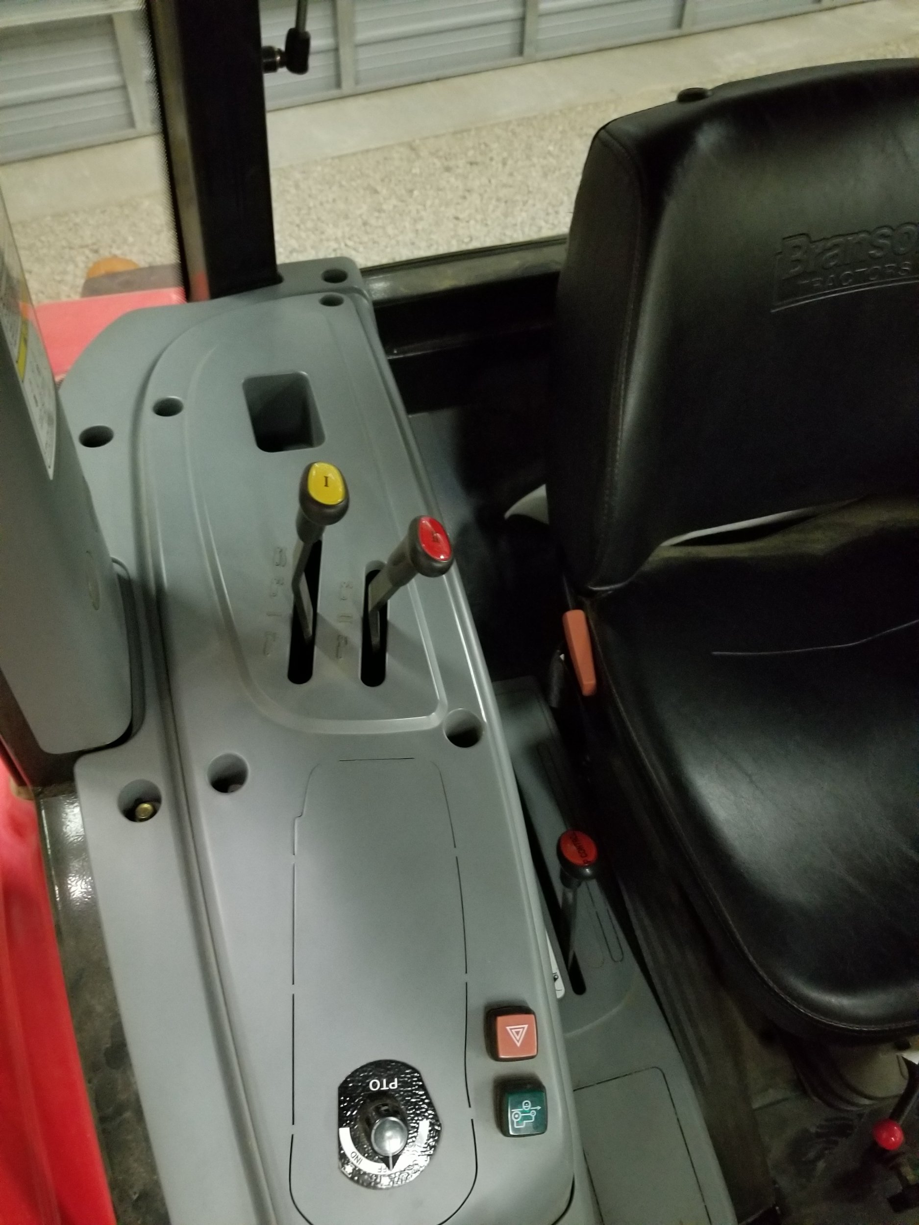

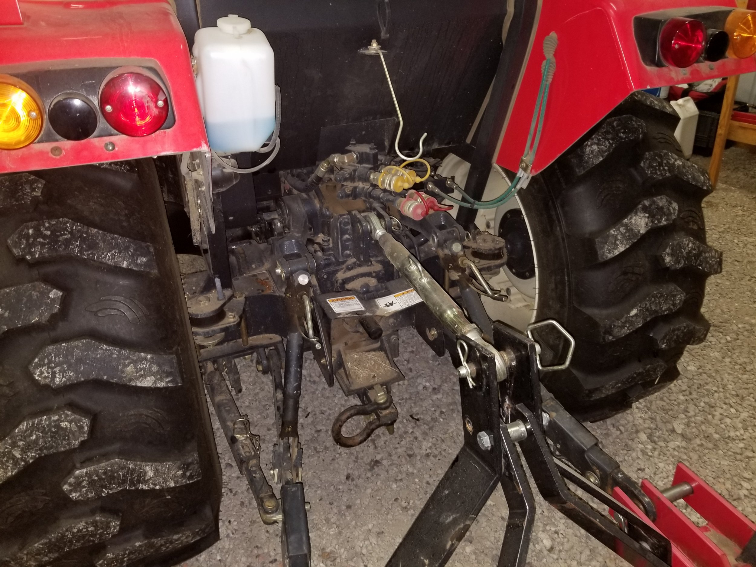

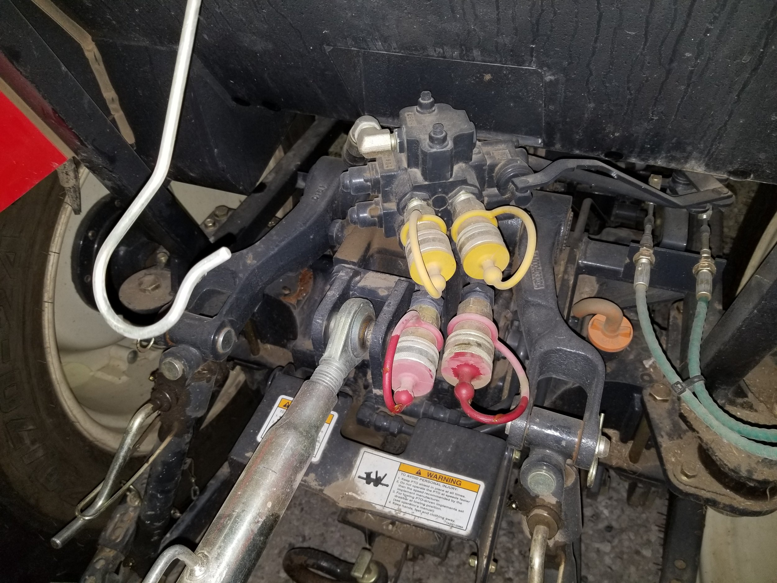

I'll take some close ups today.

These are the factory remotes that came on my 25 series.

WR Long makes a true 3rd function kit for our tractors. I think it's priced around $900.
A couple years ago the factory 2 rear remote kit for open station was about $600. On the open station models the levers are between the seat and the right fender, behind the 3pt control. You'd also need to run hoses from one set of quick connects at the rear up to the front, and if you want to do a neat job, make a bracket for bulkhead mounted quick connects. Hoses, fittings etc are around $100-150.

Thanks for the pictures. That helps a bunch.
