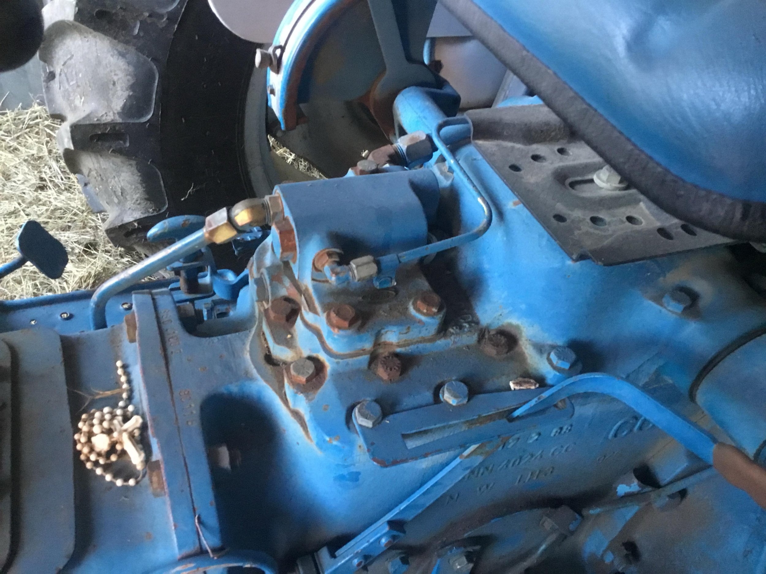

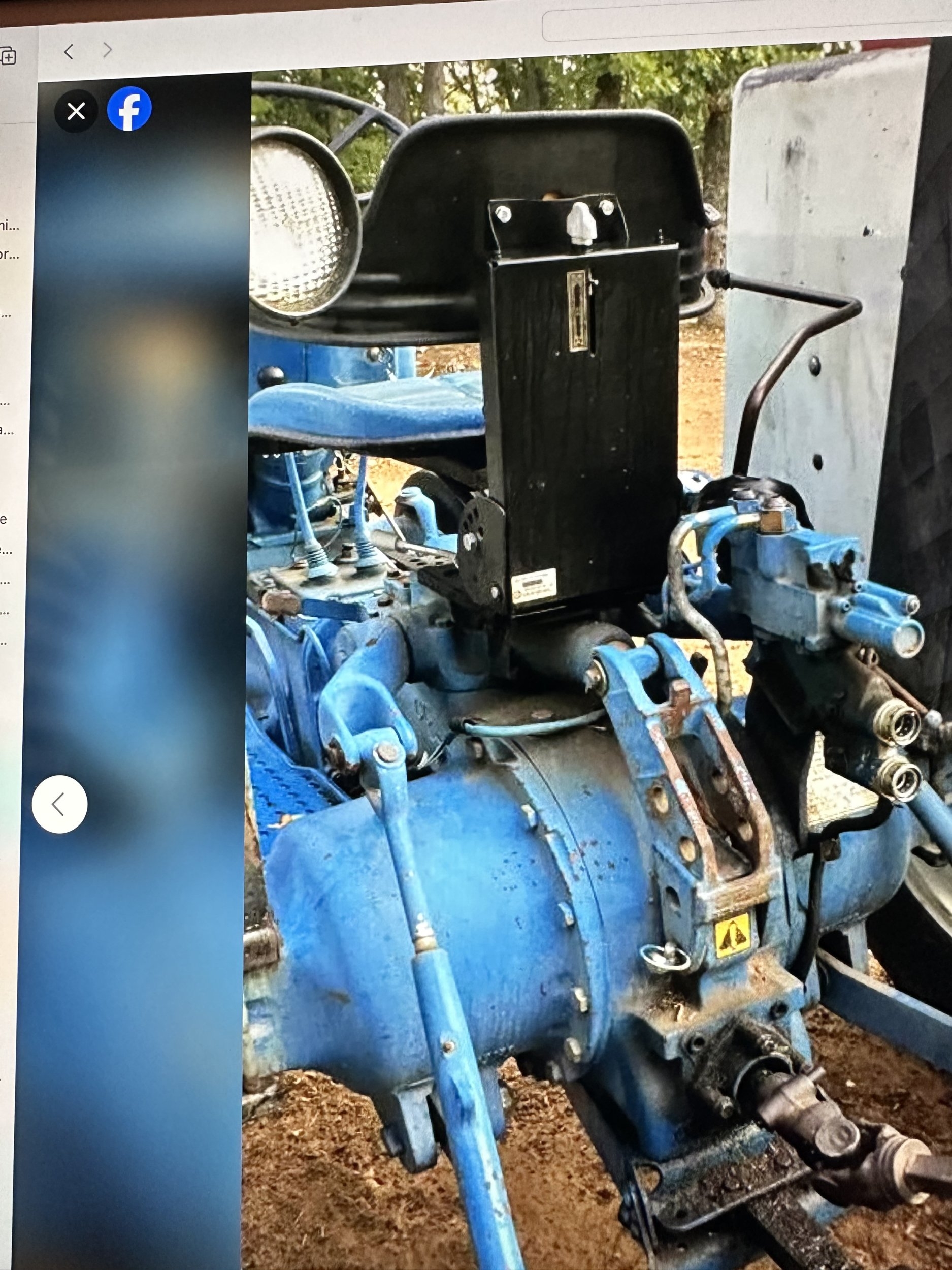

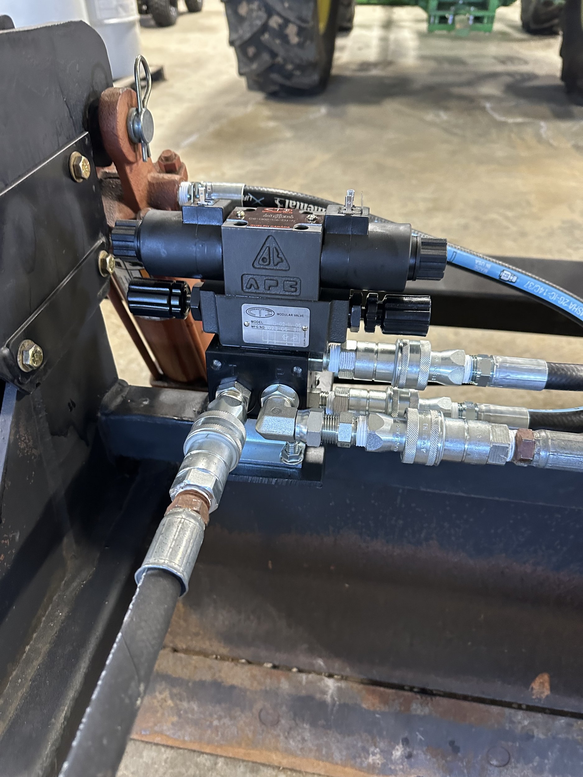

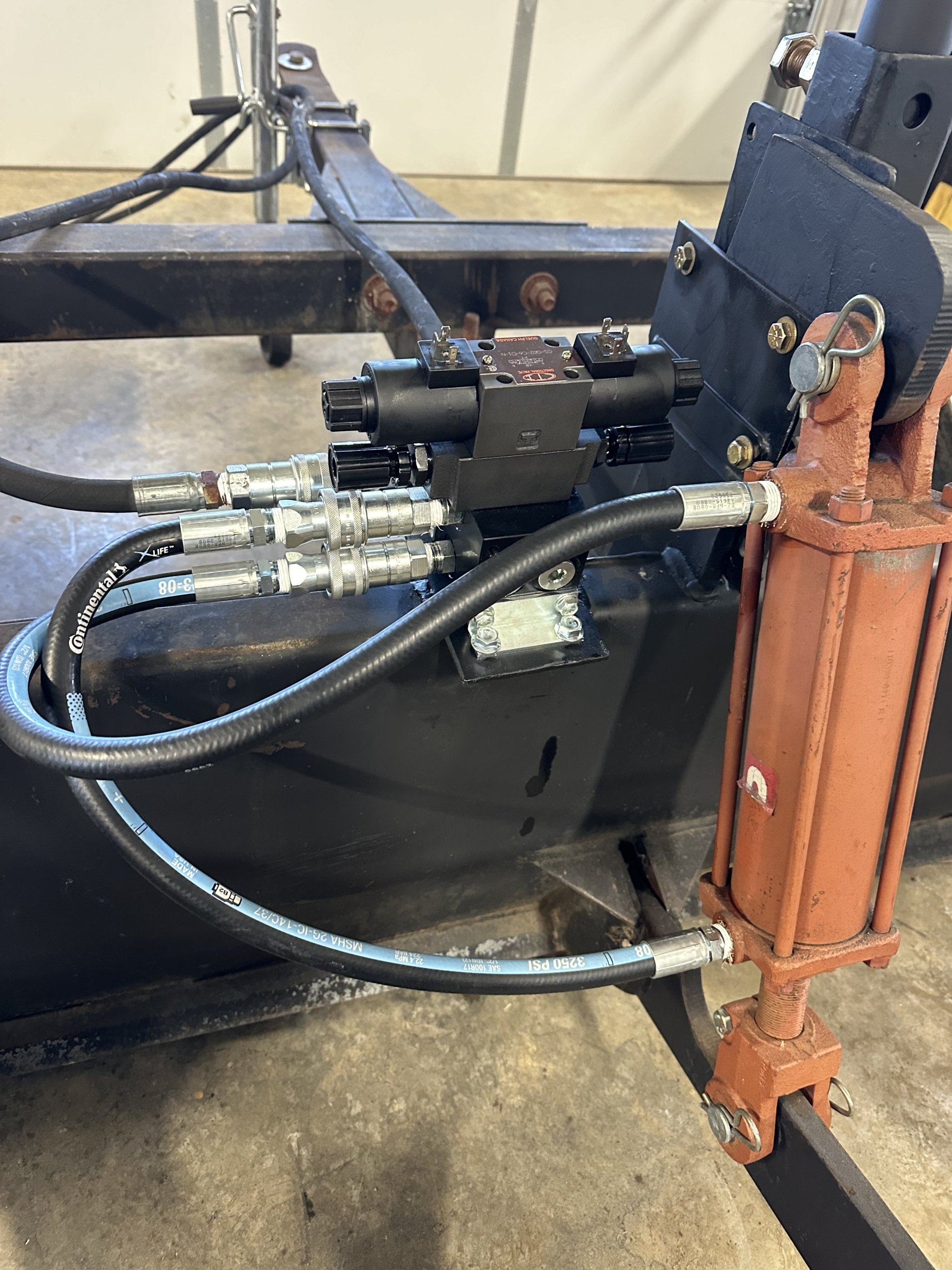

I have a 88 4610 with dual pumps and closed center hydraulics and one set of remotes. I need power beyond to run a laser controlled box blade. Can I hook up my hoses to the remote and tie down the handle and have this work without any heat issues? I don't need any other hydraulics when using the box blade. I will post pictures with my setup. Thanks

I had one person tell me to use NH Part Number 9613790 but I don't think that will work for closed center hydraulics. Im not how to plumb that part as well. It's really confusing with this type of system or Im over thinking it. Just trying to make it simple. Thanks.

You might consider a Tisco HV5902 valve block. That will give you direct flow from the tractor's internal pump and about 8 GPM. Assuming that would be sufficient for your laser system? Using the current remote valve tied back will work but that's forcing twice as much flow through the system. That might work but might also create some heat while using it, and also make the operation of the cylinders faster. That may or may not be a good thing. Using the remote is obviously the simplest route to take. Nothing to add but a bungy cord. With the sandwich block you have extra plumbing, couplers, and the need for a "loop" connection when the laser package is not connected. Also it would require a little tweaking of the steel lines in your first photo.

Are you sure that you have closed center hydraulics. Most Fords of that age are open center and per TractorData your 4610 should be open center with either an 8 or 14 gpm pump. Locking your exiting valve into position will flow considerable flow to the controls of the box blade is that control valve an open center valve or are you going to be dead heading your hydraulics and running on the pressure relief.

I don't think he really knows just WHAT he has. He's thinking closed center because that's the nomenclature that was used with the Ford "deluxe" remote valve.
It's actually the same dual pump system Ford had used on a number of models during that era. It's two open center systems combined into one closed center valve. I'm "guessing" that the laser system valve(s) would be open center. (maybe he can confirm that)
If I were doing this I think I would first try plugging into the existing remote, turn the flow control on said remote down to minimum flow. Tie the handle back and try it out. See if the laser system preforms and if so how well it performs. Maybe adjust the flow control up if needed. Check periodically for abnormal heat build up. It's certainly worth a try before investing in any additional parts and modifications without knowing it's necessary.

It is an open center with closed center load sensing valves. The laser is open center with a flow control as well. I appreciate all the info. I will plug in to the existing remote and tie the lever up and see how it works. I will let everyone know how it works. Any and all info is appreciated. Thanks.
