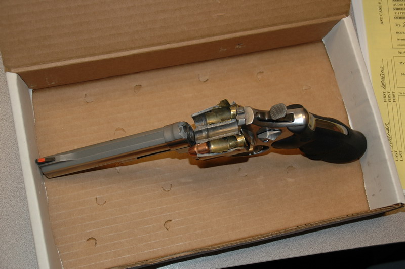

Remember what can happen with poorly reloaded ammo...not sure of the circumstances of exactly what the problem was...dredged this up from an old thread...
   / How to get started reloading ammunition #72
deffinately look slike way mor ethan proof loads!
mor elike POOF! loads. :)
