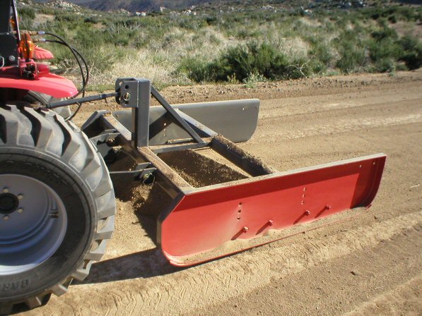

The best and easiest way is to have one of the land plane grader blades as shown in the picture. Nothing better to maintain a drive than one of these IMO. ;)

Which is why I went into some detail with how to do it with the blade that you have. I mentioned and showed a picture of the LPGB to give you an idea what you may want to get in the future if you are going to maintain this drive for any length of time. The LPGBs are the only way to go for maintenance of a drive. ;)
