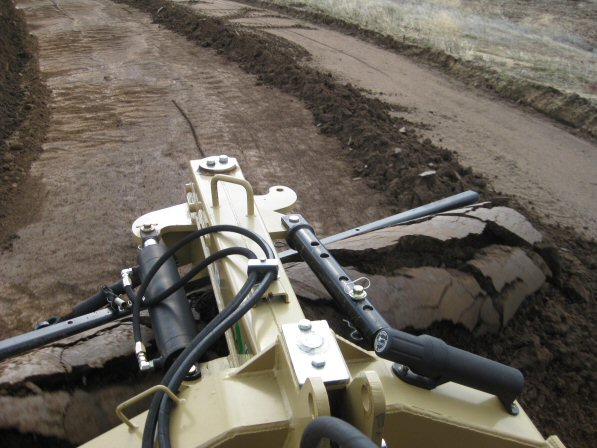

The blade I know how to angle along with some tilt, but I was wondering if any angling can be done with a plane?
   / How to grade a driveway? Need help please #57
the only land planes I've used are big boys, and they are 2 trail wheels and a bog box with nothing other than cut adjustment up or down.. can't speak for any others..
   / How to grade a driveway? Need help please #58
angle blade with side to side til helps crown, that or a top in tilt, or you have to jingle with yer lift link adjuster :)
No TNT for me, but as Soundguy suggests, I tweak my link adjuster to get it to tilt. I've got a 48" version of this and I really like it! Two passes down the center with the plane level and then one or two with a 1/2 bubble tilt (using a 4' level) and it will put a crown on the drive quite nicely! :)
Word of caution: Remember which side is tilted down, fixing your error if you don't is a bit time consuming... :ashamed:
   / How to grade a driveway? Need help please #59
Yes it can be done as long as the cutting edge is below the skids, but it is much faster with a rear blade, for me anyway. ;)
