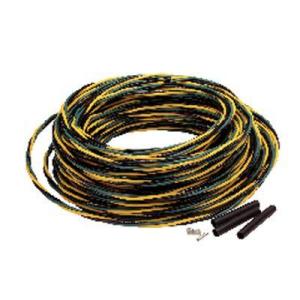

New wire is recomended. It really isn't that expensive to run four conductors of #6 copper from the house to pole barn.
Yeah, it is. Run either 2-2-2-4 or 2/0-2/0-2/0-4/0 aluminum mobile home feeder depending on future needs.

Let a neighbor use the back-hoe to bury his pet last year and he severed my UG phone line. Power Co guy replaced a section and sealed both splices with epoxy/cartridge 'kits' that resembled the silicone/PVC/cap setup mentioned above. I looked 'em over and was pretty impressed by the details. Wish I had asked if he knew where I could buy something like that.
Here in MI conduit has become a code req as of a decade or so ago. Heat-shrink tubing seals to water repellant but if submersed is only temporary, and a gamble at best. btw: I've seen HS-tubed stake-ons with a goo inside for marine use, but it looked more like a silicone grease than a 'glue'. I hope the OP will be able to redo his run with something better next time. (Until then I'd use the silicone & PVC tube method, with a bleed hole midway between the caps to let air out as the silicone goes in.):2cents:
Heat shrink is about all you get with a well install now-a-days..
I do hope it's copper wire that you'd get with a well kit ... vs aluminum. :confused3:

I hate to admit it but I once did a repair like you're talking about. I bought the heatshrink kit and spliced in a new section of wire. I didn't like just heat shrink so I slid a piece of pvc conduit over the splices and then used automotive urethane used to seal windshields to seal up each end of the pipe. Of every sealant I have used none is as durable or lasts as long as it. Plus you can get fast setting so it'll dry in minutes so you can bury it much quicker than any other types of sealants.

Industrial Toys,, very good that you bought up what happened to you....This confirms what BuickandDreere and I had previously posted.... There is no fix for electrical power wires which are buried or placed in conduit in the ground which do not have insulation which is specifically designed for that application... And that is the root problem here.... the wrong type of wire was used in the ground to begin with....
