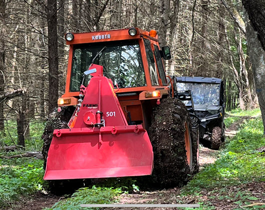

Hi All,
I am using a farmi 501 for skidding some logs. I have tried multiple ways of carrying the chokers on the winch while not in use, but they continue to fall off and get lost. At $50 a pop, I am trying to figure out a way to secure them to the winch, but also keep them easily accessible. I have found myself checking to make sure they are still there when driving the tractor with a grapple full of logs. Taking my eyes off the load and the trail to check the chokers is dangerous and I need to figure something out!
Thanks

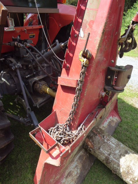

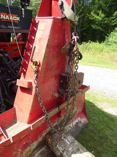

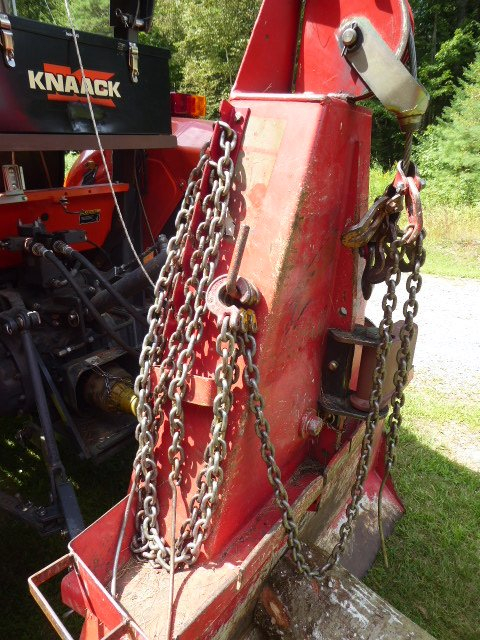

I have a 501 too and carry them a number of ways. However they end up or what ever is convenient. I carry 5 chokers. 3 one side 2 the other. Never lost any. Usually I have one or two in a slider and on a hook like so
Or just hanging on the hook and draped in the box.
I also made that hanger out of a piece of angle - drilled some holes and cut slots at a 45. Then bolted it on. In winter the box gets full of ice so the hanger is handy or some times the box is full of other stuff.

Thanks all. I have been using the box so far but I keep having the chains bounce out of the box when the tractor goes over bumps. I have been hanging the hook end up higher on the winch but then the loose chain end somehow finds its way out of the box and is dangling from the winch.

Genius! Simple cuts in angle-iron.

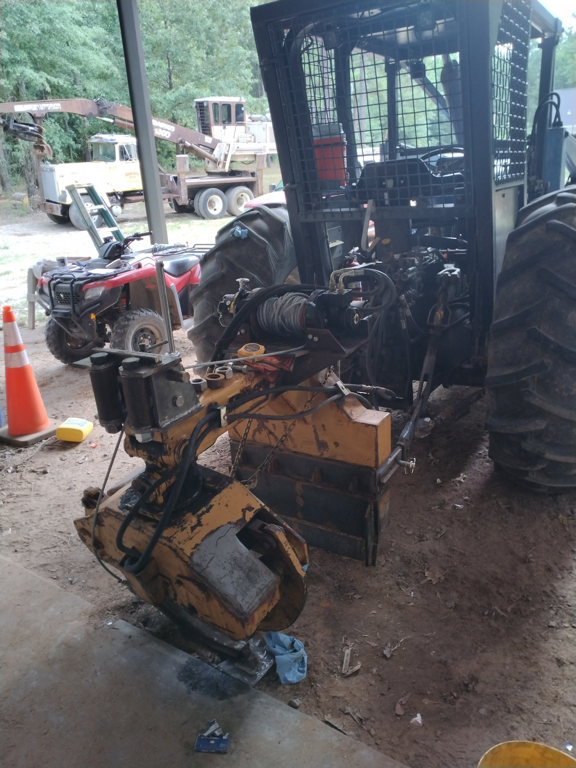

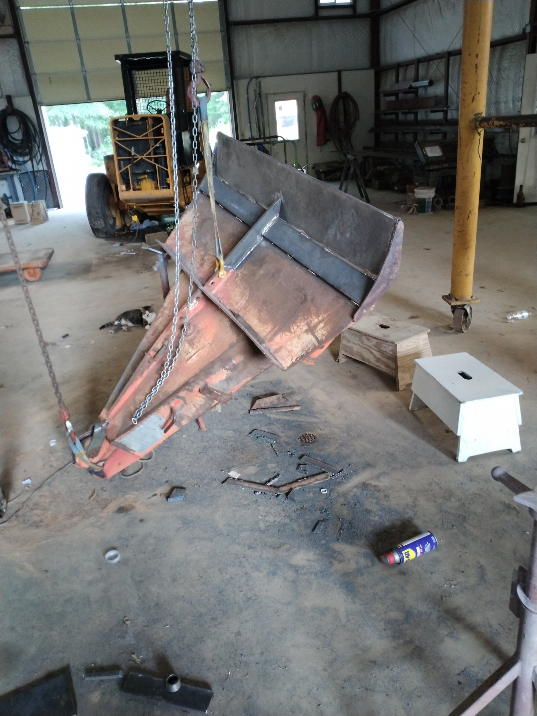

Never had a problem with losing chokers. We put a new bottom on the Farmi, it was bent.
