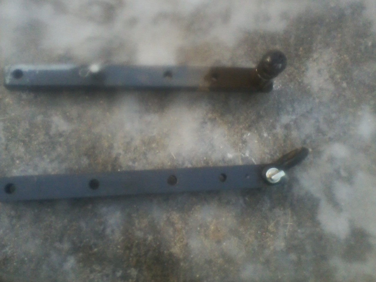

I just use the tractor draw bar with trailer ball 1221171506-00.jpg1221171507-00.jpg
