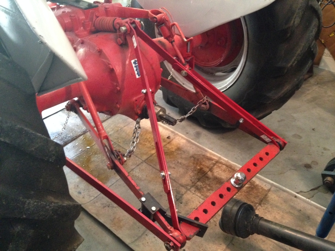

There used to be a kit for the N series Ford tractors which didn't have drawbars. It was a chain to keep the three point drawbar down (I don't recall what it hooked onto) and ALSO a chain that prevented you from lifting the three point control. If you chain the three point down, somehow preventing yourself from lifting it accidentally seems pretty important.
   / How to keep #pt from floating up? #17
Here's a view from a set-up similar to what we have for our 8N (before we bought the swinging drawbar kit)
The bars that go from the inside of the lift arm up to the 3pt top link are what keeps the lift arms from rising.
The black piece in the bottom corner is used to keep the draw bar from rotating - needed if you're using a ball type hitch.
