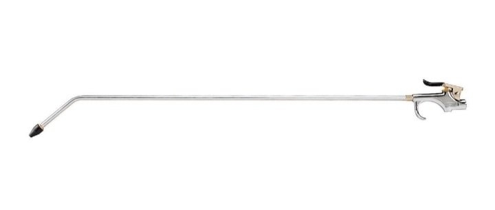

$7.99 Harbor Freight works well for me.
That and a leaf blower.

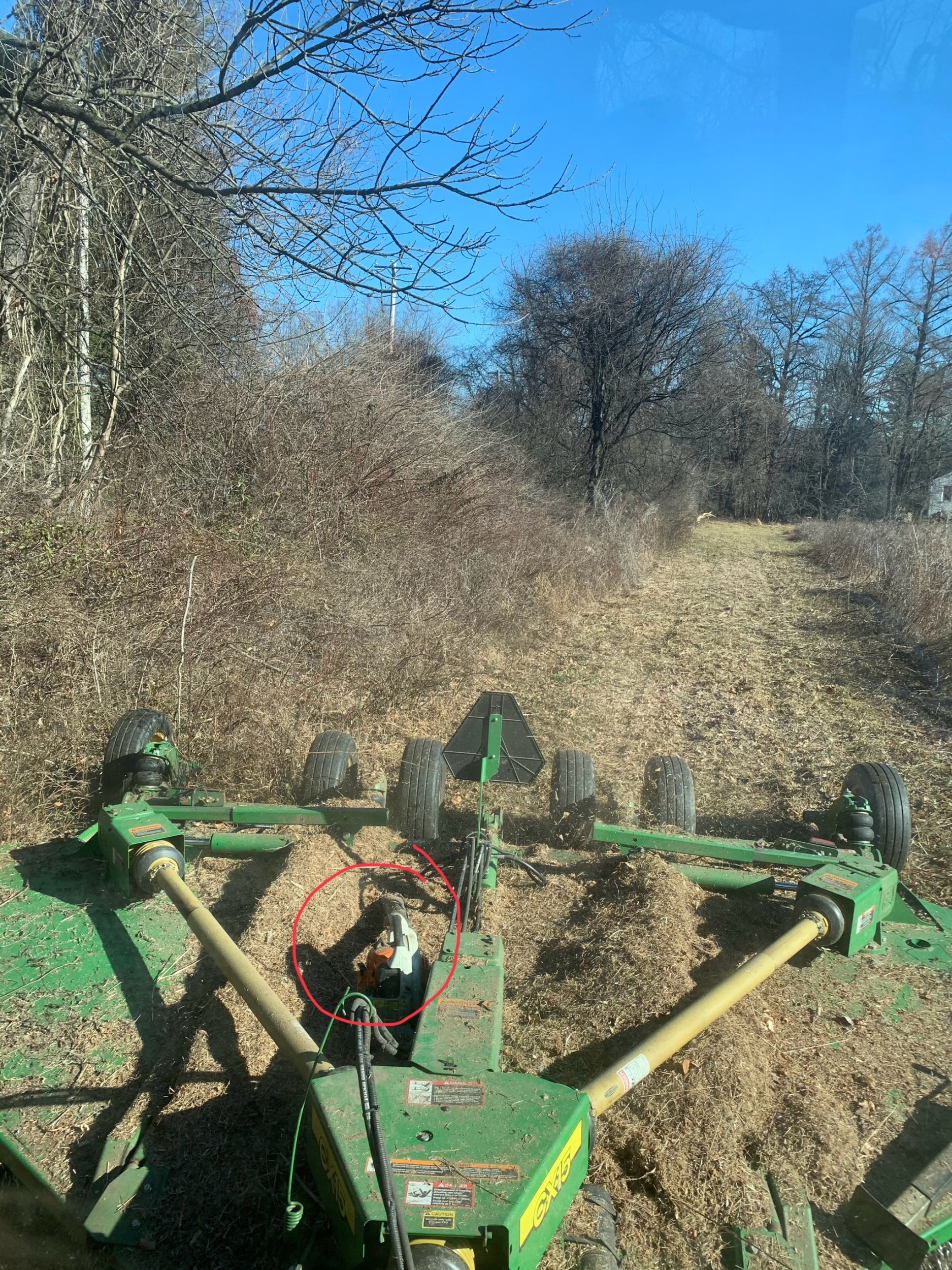

I carry a small leaf blower with me when I'm doing any work that might plug up the radiator. It works great and only takes a minute or two to blow out most everything.
I do this, too. Helps to blow off not only the radiators, but the mower deck, too. I just keep a Stihl blower on the mower deck.

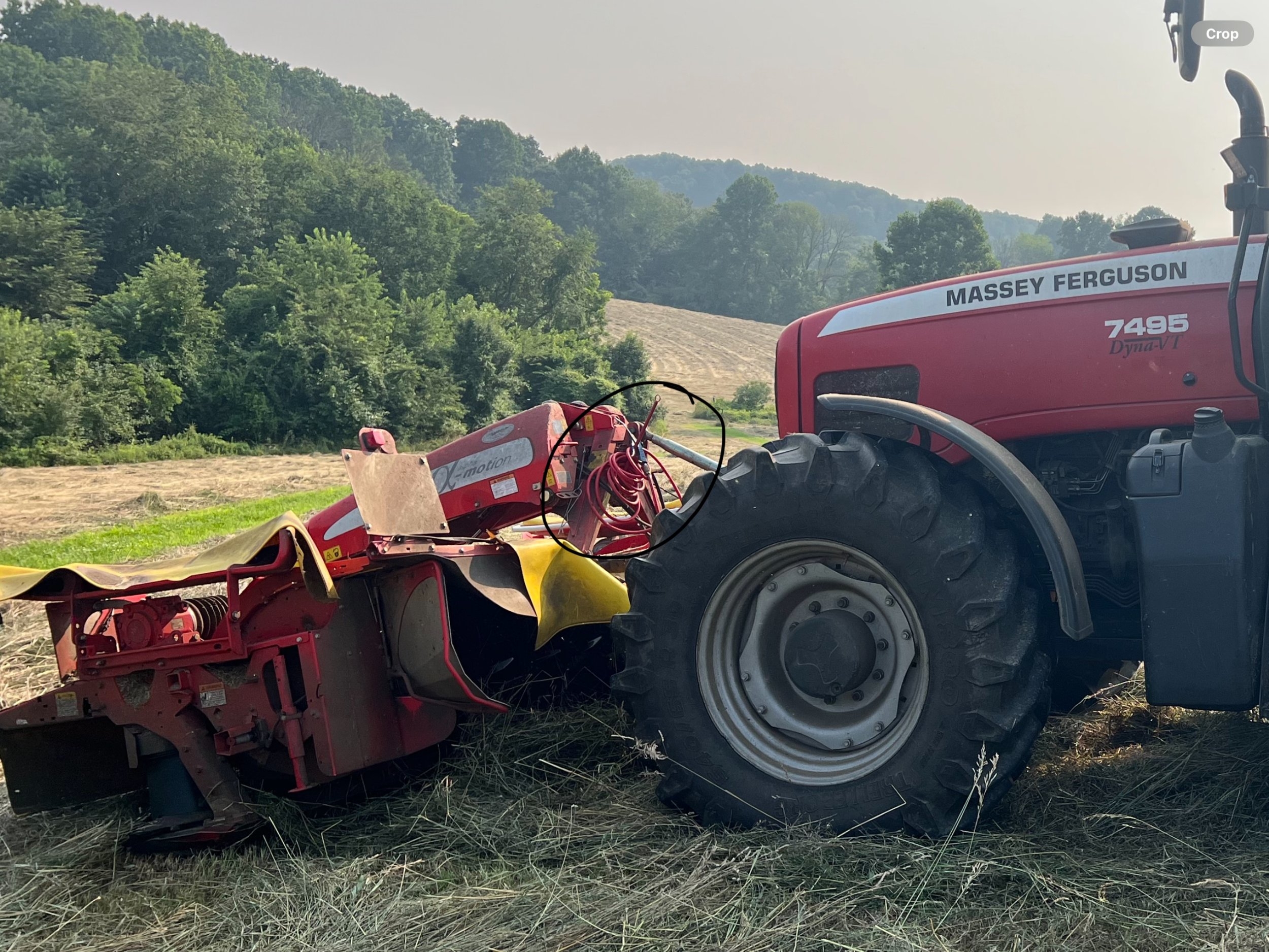

Massey has air brakes so I tapped into the on-board air compressor and routed an air compressor coupling to the front. Then a compressor hose & blow gun. On windy days, the hay chaff is real bad. Sometimes have to stop every 2 hours
