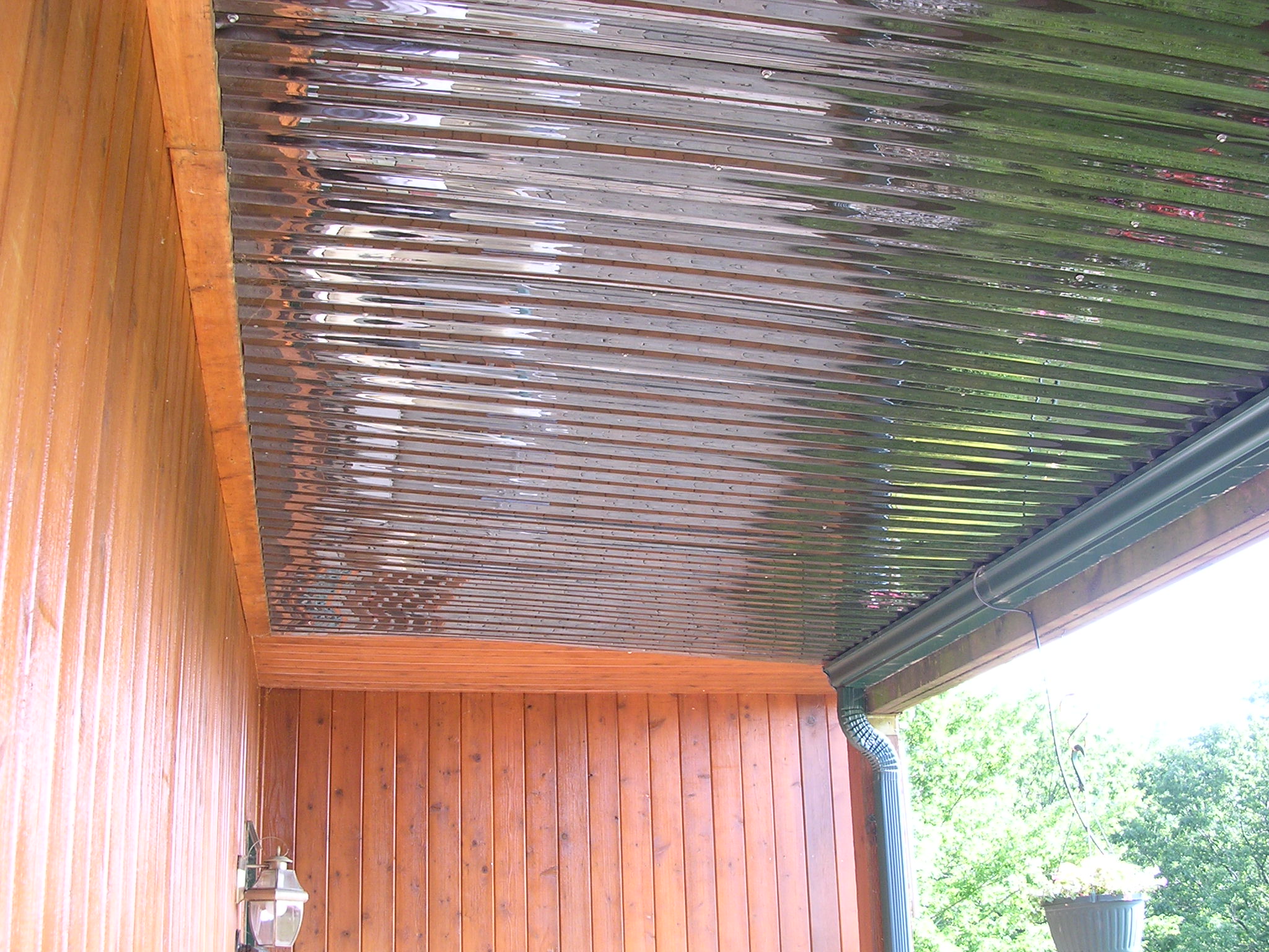

Pixguy, that ceiling looks very good. Clean, neat job!
   / how to keep stuff dry under new deck- need ideas #14
Thank you, I hated to lose that space when it rains and have water dropping on us from overhead.
Plus it was a great place to store my MF tlb until I built a garage for her. :D

I did similar to pixguy but more low tech.
I used bent coat hangers for hooks and suspended some spare pipe at either end of the plastic and one for the middle.
I then just laid several sheets of the corrugated roof plastic on these with a little overlap. Lot's of "stuff" filters thru the porch so I take it down every once and a while to rinse off.

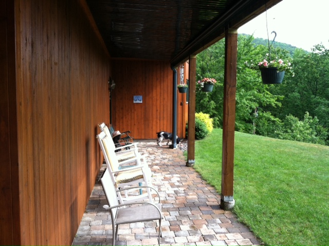

Whatever you do make sure you have a way to get to the top side for cleaning you will be amazed how much stuff will get trapped up there.
I did the very same thing...I think it cost me less than $100 and we are always dry underneath...it has been about 10 years..plastic does not rot and it has held up well..we rinse once a year with a little bleach in a each gallon of water..
   / how to keep stuff dry under new deck- need ideas #18
Sorry for the Iphone photo that light the actual cover, but here's a photo after we got lots of rain last night, and kept the furniture under deck dry.
