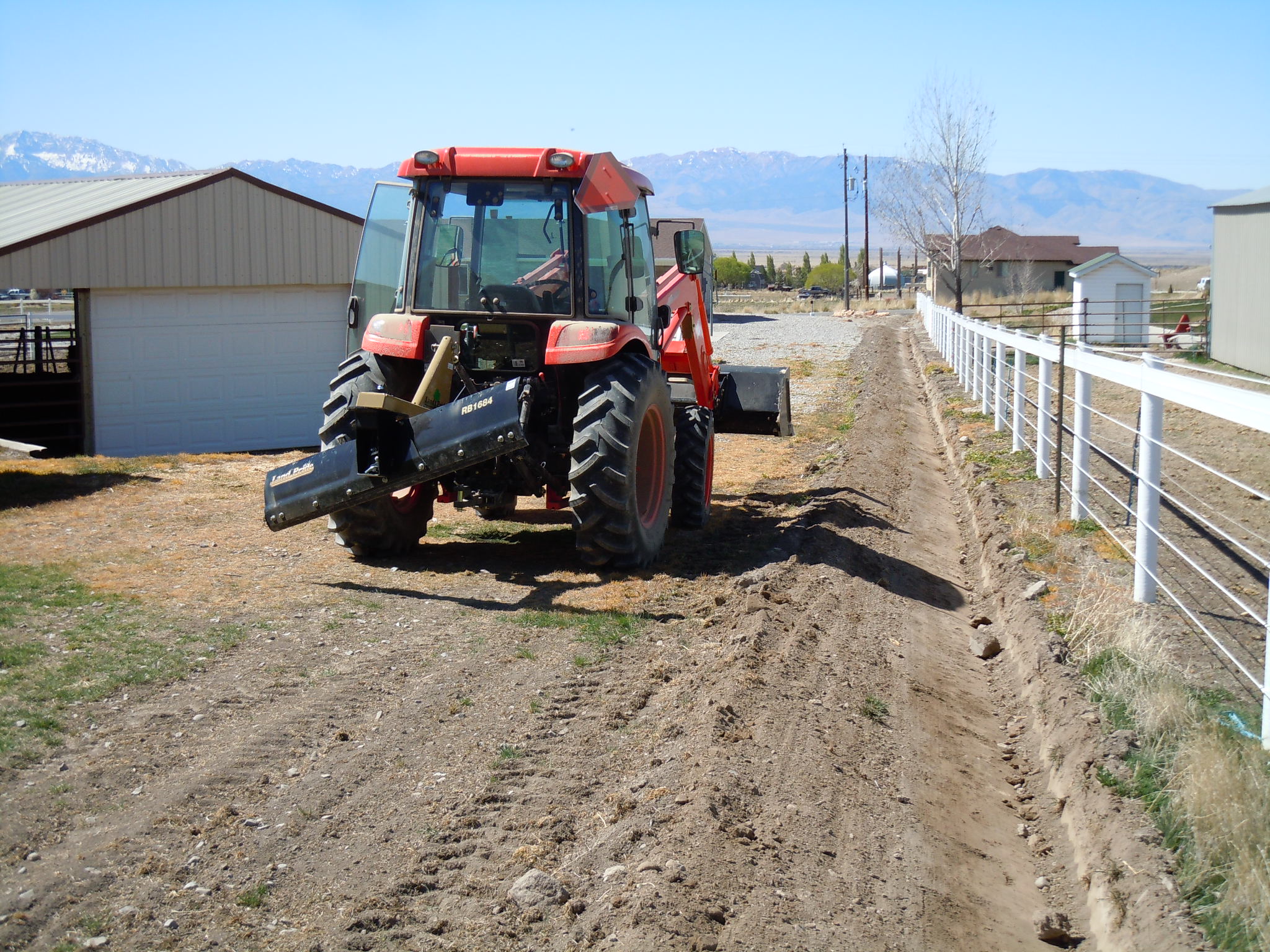

Build the ground level up such that it funnels the water to one spot. (does not take that much) Then put a sump in with a float activated pump, then pump the water to the gutter. Maybe the neighbor would help with the cost since it is their runoff causing the problem. I had a similar problem but it was easier to fix. See the picture. DSCN1915.JPG
