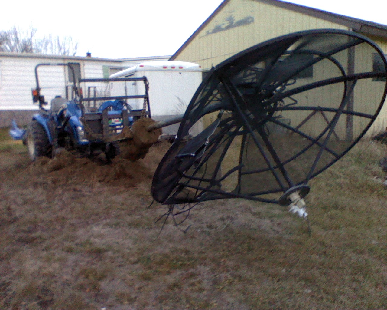

Actually did this tonight. Wouldn't intend on doing it often but was moving an old C-band satellite dish, post, and concrete base I had just ripped from the ground. Wasn't super heavy, but the full length of the dish at the end of the mast was straight out from the front of the tractor. I placed the forks slightly less than the diameter of the base apart and forced them around it, then rocked and pulled. Once out I just kept driving forward to its final resting place.
Anyway, one part of the route involved a slight downslope which finally moved the CG far enough forward to lift the rear up and over, canting the tractor against the axle stop. Once on flat ground again everything leveled out again.
Again, not a normal practice and my hand definitely never left the joystick.
What surprised me is my reflexes were fast enough to out pace the F-22 jet fighter characteristics that overloaded tractors have. Maybe I should enlist with the Air Force? :D
Did I ever mention how much I love my forks?
