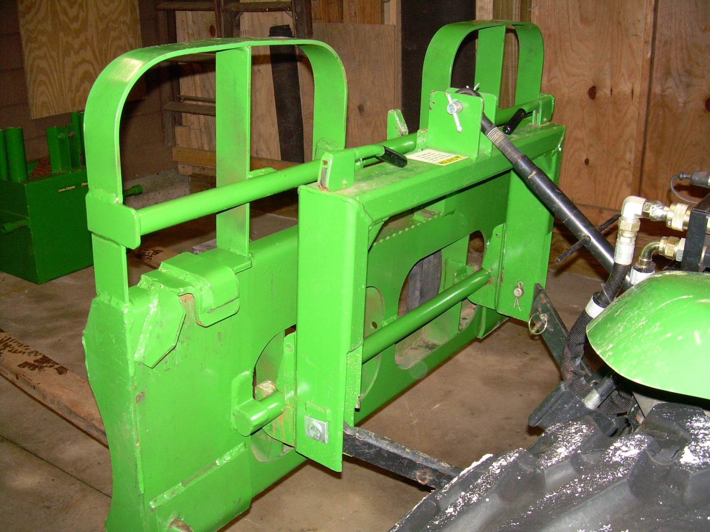

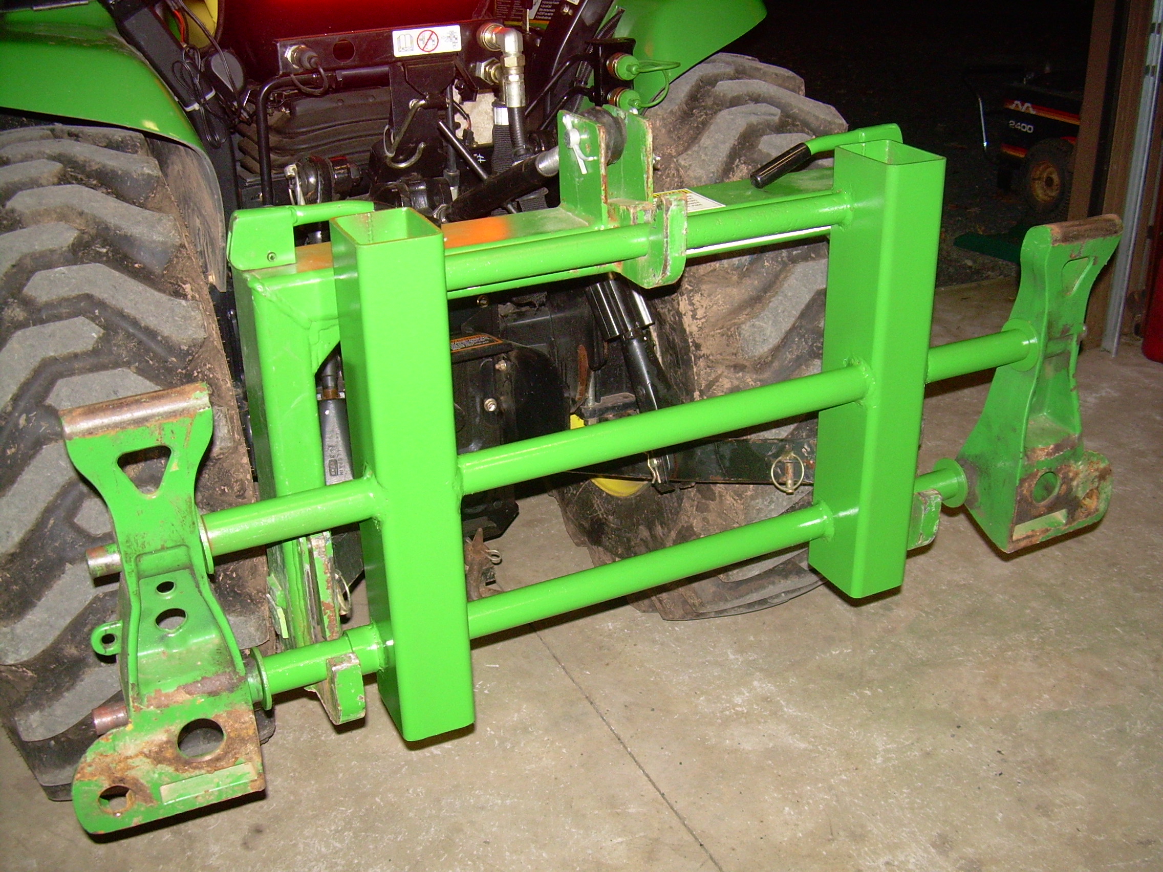

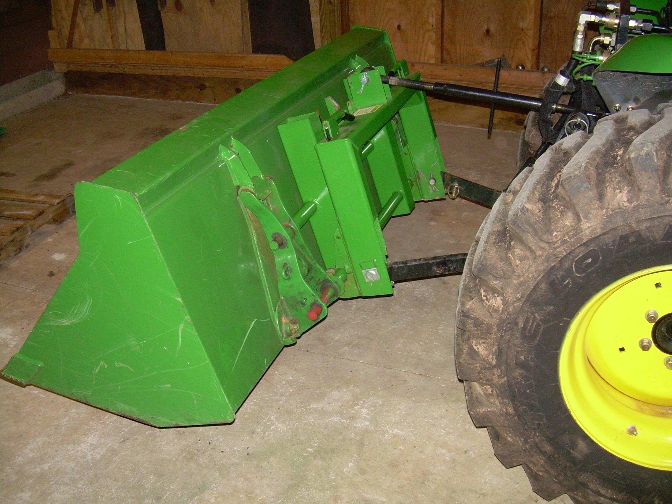

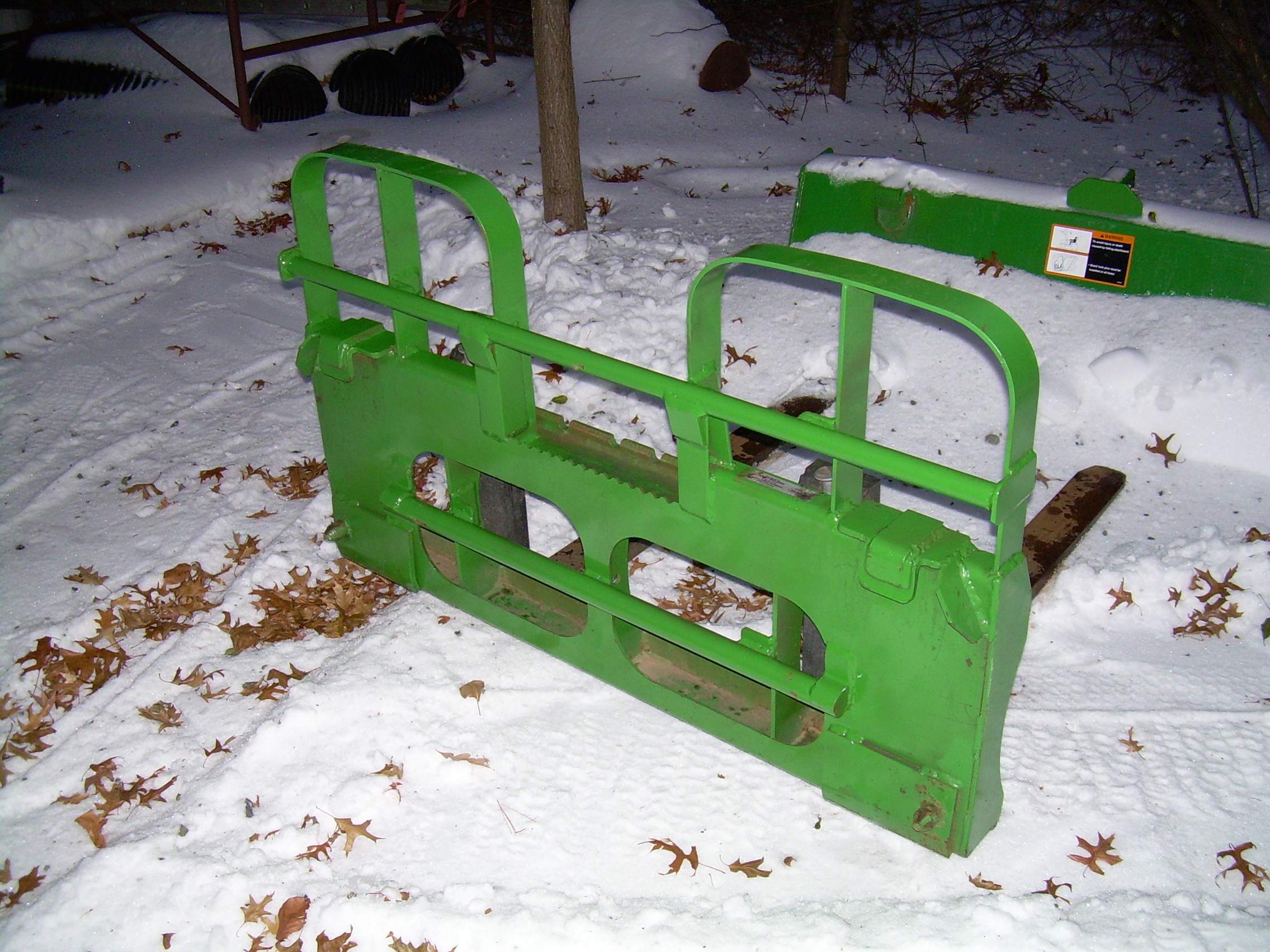

Yeah I couldn't live with out my quick hitch, had to do a little modding but well worth it.
Get a HTL and you really got it made, especialy for forks.
I have hooked chains to my Imatch but was a little worried about doing damage.
Here are my forks,
I could use mine 2 different ways on Imatch, one is the way I modded the fork frame with round bar stock, forget the exact sizes but they are standard, and fit tighter than other stock pins or bushings. the other way is with a Frankencontraption I made with some extra loader carriers I had, also with bar stock, this was jus a fooling around project but it does work.
I mostly just use it with the bars on the frame.
JB
Here are my forks,
JB
Hi JB: That looks pretty cool. You need to install an hydraulic top link to get full use out of the bucket on the 3PH. Next project?
Mars
I've got one now, since that pic was taken. The bucket adaptor is kind of a gag but it would be good for needed trunk space, tools etc. not enough range in HTL to use bucket for digging/dumping though.
Wouldn't want to be without HTL now that I have one.
JB
