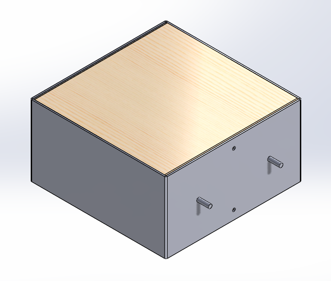

Picked up an 8-foot 2x12 after work yesterday along with some of these Spax lags:
SPAX 1/4 x 6 in. Yellow Zinc Washer-Head T-Star Lag Screw-4581020701527 at The Home Depot
Got the wood cut and clamped together and started to put the lags in. The little labels on the lags specifically says "no pre-drilling required". Well that is a bunch of BS cause they cracked the wood. :mad: I did two corners an inch in from each edge (and it split with the grain on both corners) before I stopped and decided I'd had it with the fancy lags. Went out and got some heavy-duty construction adhesive and used copious amounts of that to bond the layers together and reattach the one strip that the lags had split off. I actually got a little over-zealous with the adhesive, as I had to clean up a bunch of it that spooged out when I clamped everything together. :ashamed:
The construction adhesive will probably hold everything just fine, but to make doubly sure the layers never shift laterally, I'm also going to make a steel perimeter frame to go around them out of 1/8" plate. Two studs for the garage door handle and two holes to put screws/lags in to keep the wood in the frame (and, yes, I will be pre-drilling holes in the wood for those screws/lags). :duh:
P.S. Home Depot will be getting those fancy lags back.

   / how to lift / support rear end of TO-30? #13
i always pre drill a lil to relieve material..
