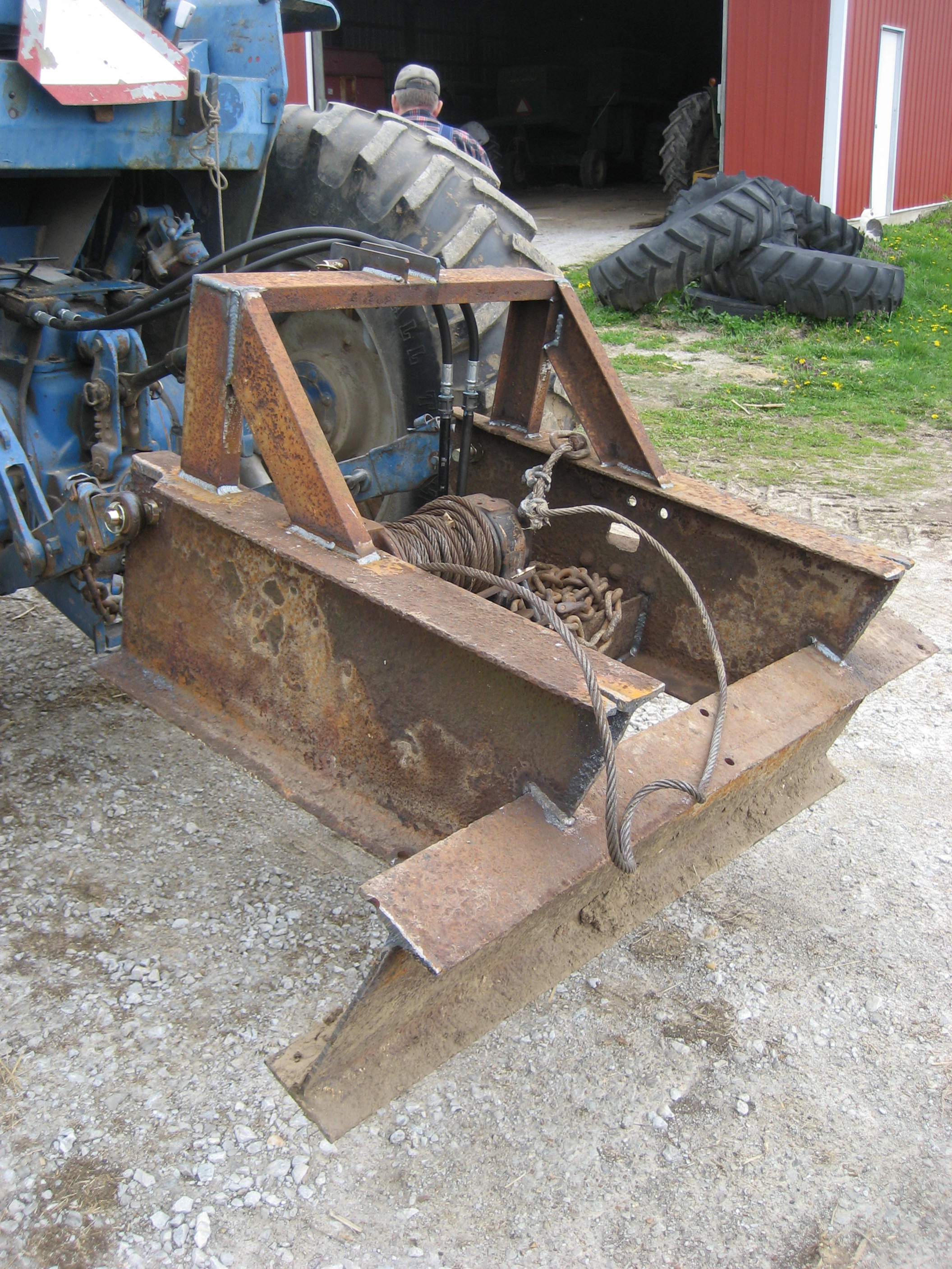

I bought an old hydraulic winch from a roll back truck and my dad and I designed and built this one. Works really good.
