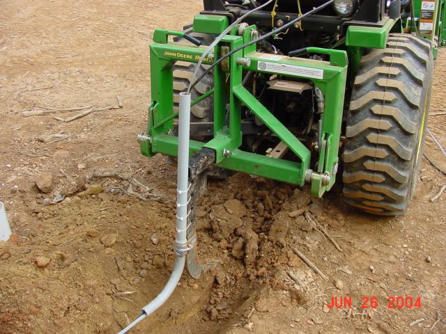

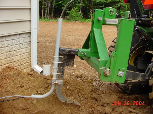

I like it, just the kind of info I was looking for. I had not thought of the problem at the end of the run being able to remove the tubing from the plow ! Thanks.
   / How to make a plow device to bury plastic tubing ? #22
If you don't have a lot to do, you can use a subsoiler without any added pieces. When I did 100 feet of 3/4" tubing from the house to the garden, my wife just walked slowly along feeding tubing in directly behind the blade. It worked fine, and I think she would have been willing to do more. :)
#23
Did a couple of runs last summer with a home made plow with less than satisfactory results admittedly I did not have a Subsoiler
   / How to make a plow device to bury plastic tubing ? #24
I believe this is the one made by KennyD.
