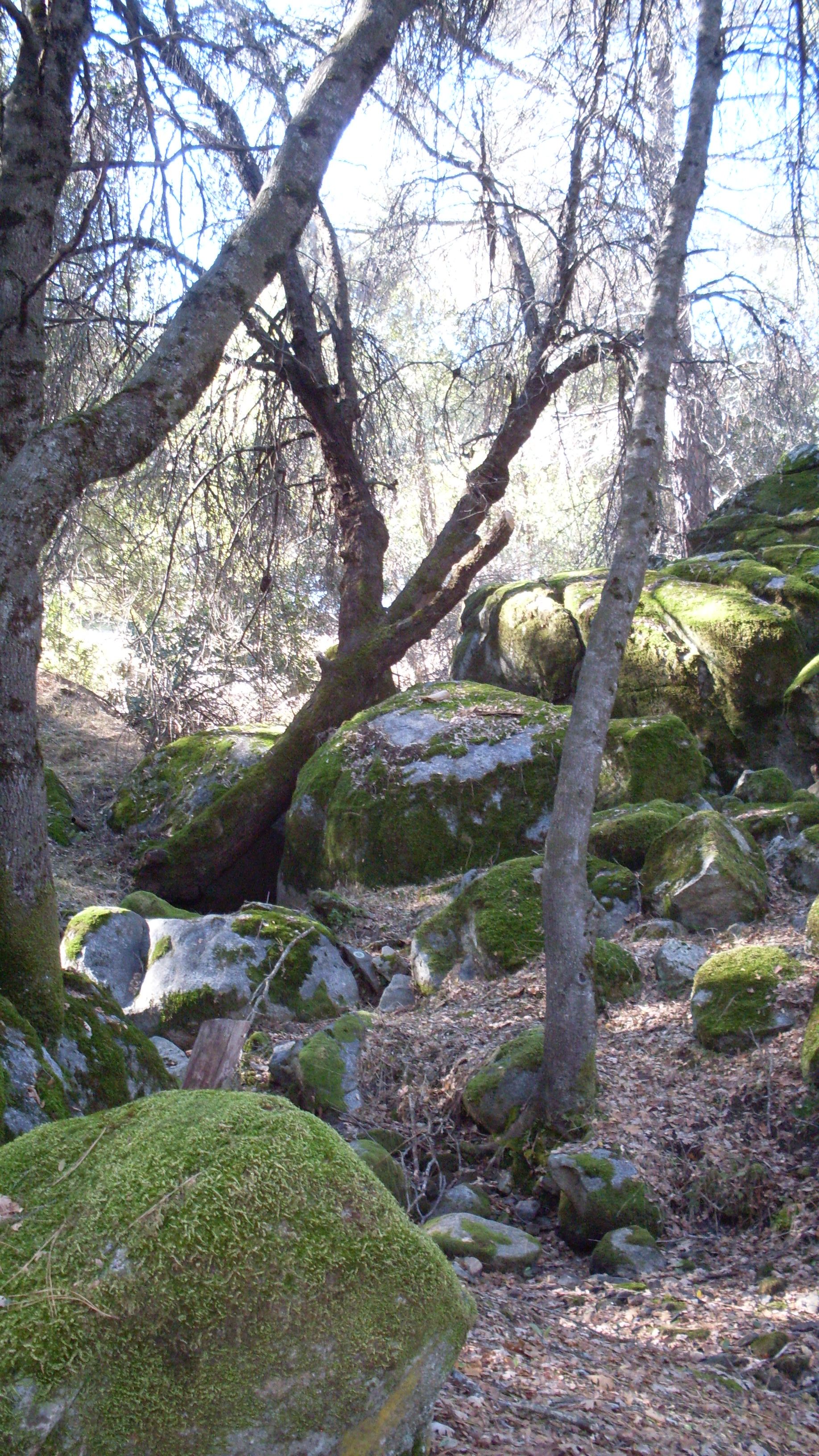

Skidded plenty of logs over the years with 3PH / chains / cable ...on flat ground... but now have some real nice fallen red oak trees down in a ravine on my property and thought I could lift /pull from higher angle with winch added to top of bucket to keep logs from digging into ground when snaked up hill ( have about 800# counter weight on 3PH ). Thanks for the input guys....
You are probably not going to get enough height to make winch practical... Probably need a skidding cone (I know has other names) to keep cut ends of logs from digging in....
THis is my issue, can't get close to tree, and can't get tractor in because creek is about 3 feet from where picture is taken...
My interpretation of your post is that you would like to pull the oaks uphill, suspended from the bucket, with the tractor moving in reverse.
With forward placed engine and oak weight on the front of the forward placed FEL, possibly 75% of the tractor + oak weight will be on the front wheels moving uphill in reverse.
Highly likely tractor will pivot on the front axle/fulcrum, lifting the rear wheels and 800# counterbalance in the air.
Besides, you will have very little traction moving up hill with the tractor in reverse.
Heavy work should be done from the Three Point Hitch. I suggest a cross-drawbar which can be hydraulically evevated 6" to 8" and moving uphill with oaks chain-attached to cross-drawbar, downhill from the tractor. You may need to carry a scoop of dirt in your FEL for front weight, depending on the slope. (Do not raise cross-drawbar higher than rear axle height.)
SAFETY FIRST.

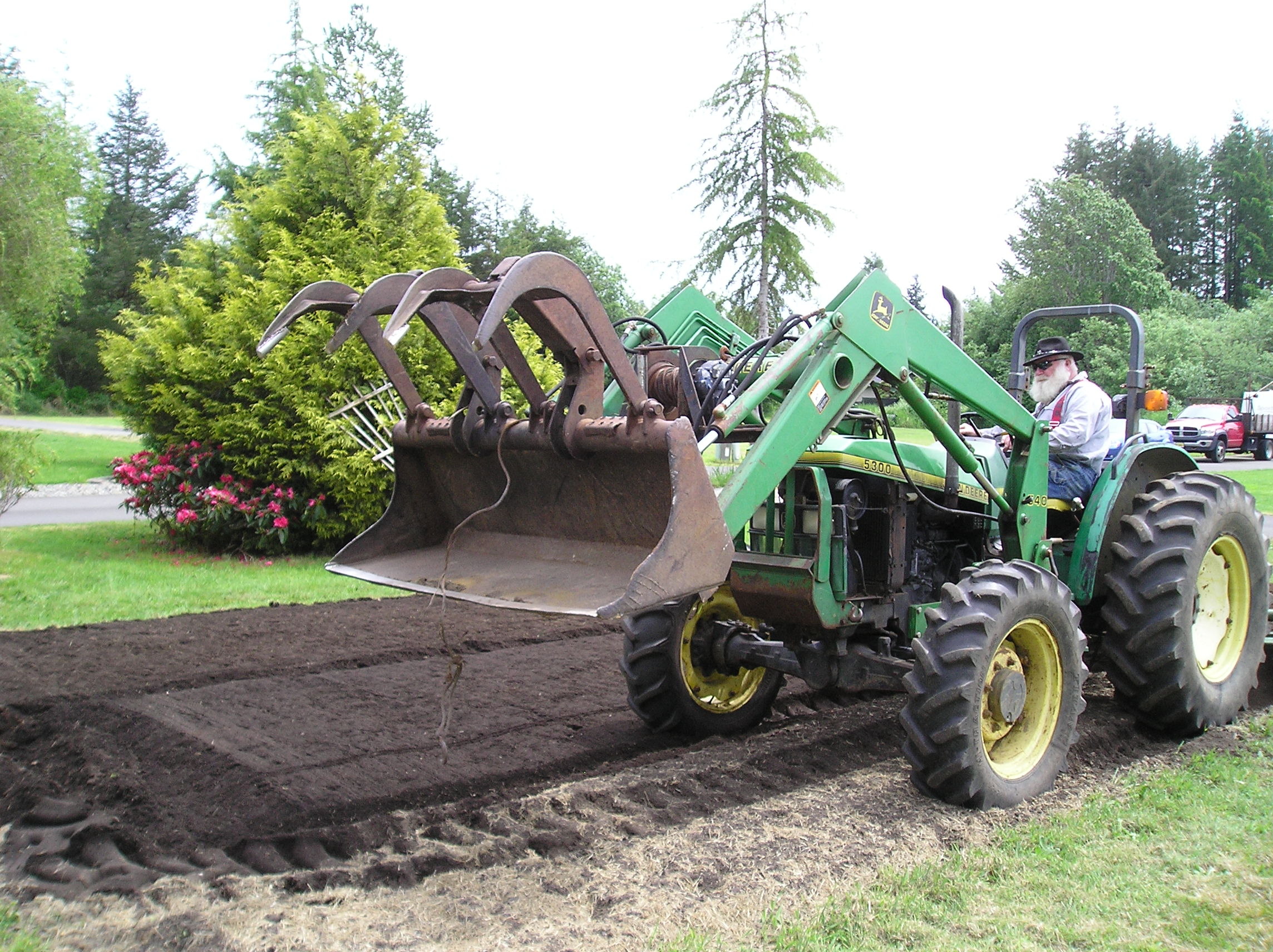

I mounted mine in the loader frame behind the bucket. It is there permanent. sometimes when pulling hard putting the bucket in the ground as a deadman really helps. It is also great for picking things up. Rolling the bucket forward so the cable does not go over a sharp edge is nice and you always have the right length.
I wouldn't recommend using a light winch as there are shock loads when you have hangups. at least a 4500 on the smallest of tractors. The planetary gears will be stripped out.
