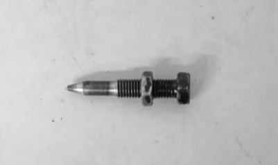

I like your idea for disengaging the drive motors. Especially because it doesn't require opening any hydraulic lines. The model I need to move is a B series so it has the ability to install the bolts to release the brakes. Do you or anyone happen to know how long the bolts are that are used to release the brakes?

5600 brake tool.PNG Not sure of the size. 3/8??
   / HOW TO MOVE A DEAD TOOLCAT #7
Yes, I have the photo from the manual also. My plan was to remove the existing plug and match the threads to a longer bolt. The only issue is I don't know how long the bolt is in the photo. I guess I could try to scale its length from its diameter.
   / HOW TO MOVE A DEAD TOOLCAT #8
If we knew if it was a 8x1.25 or a 10x1.5, you could scale the thread pitch to the bolt length.
#9
Try probing the depth with a screw driver once you have the plug removed.
   / HOW TO MOVE A DEAD TOOLCAT #10
If helpful I have a set of the Bolts to disengage the axles and will measure them tonight after work and post back here. Unfortunately I have a Council of Governments meeting tonight so I won't be home until after about 10:00/pm.
