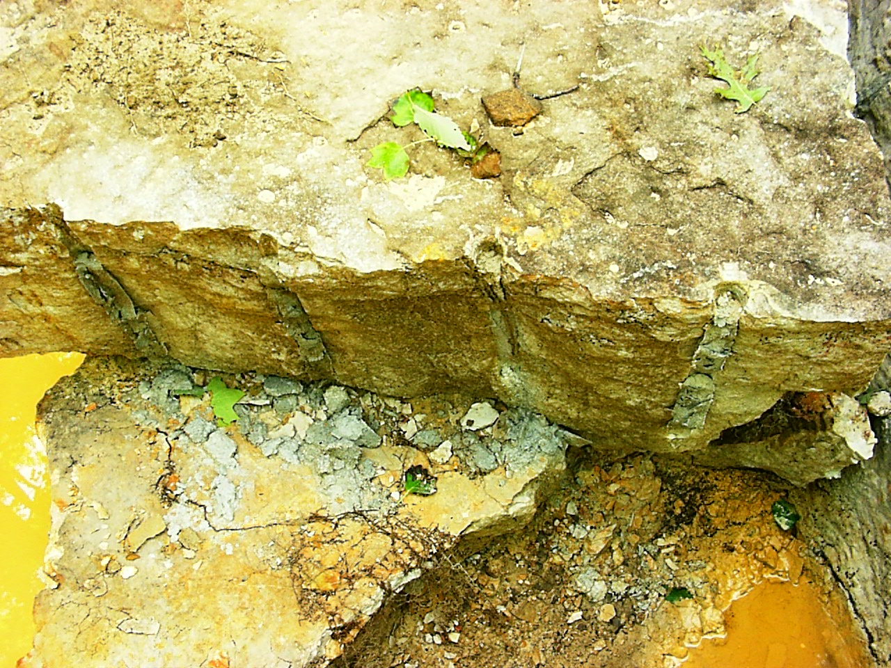

Cowboy, I think the wood (unless old and very hard) would absorb the pressure the Dexpan creates. After looking at the cross section of the hole, it does not appear that the Dexpan expands that much. On both breaks, the fissure followed directly through the center of each hole leaving a perfect cross section to view. Good news is that the wife went up to the property last night so she will get some pictures. My fun begins when I get to move them this week-end.
