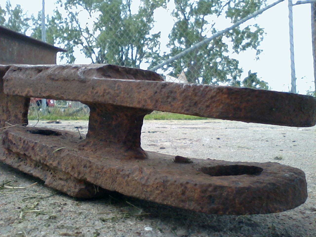

What would be the best way to straighten the lower member of this trailer tongue? Its 1/2" thick x 2 1/4" wide. I'm afraid if I try prying / wedging against the top, the top will bend up instead of the bottom bending down. I don't have acetylene torches :(
The only plan I can come up with is to run two or three welds across the bottom piece then drive a steel felling wedge between the top & bottom with my sledge hammer.
Hoping more experienced minds here might have a better plan or be able to tell me why mine will or will not work.
   / How to open this up ~ 1/8"? #2
That will work. Make sure you make the welds on the ground side, as it is pictured.
Thanks! Going to have to flip the whole trailer over though, getting better at vertical up, no way I'm attempting overhead or upside down or whatever it's called ;)

If you are already thinking of arc welding on the tongue. I would first saw a kerf in the piece at the place where you want it to bend, drive your wedge and then weld up the cut. The cut will make the bottom piece weaker than the top so it should make the bottom easier to bend back into line. My two cents.
SimS
   / How to open this up ~ 1/8"? #6
SimS
Now that is an idea I would not have thought of.

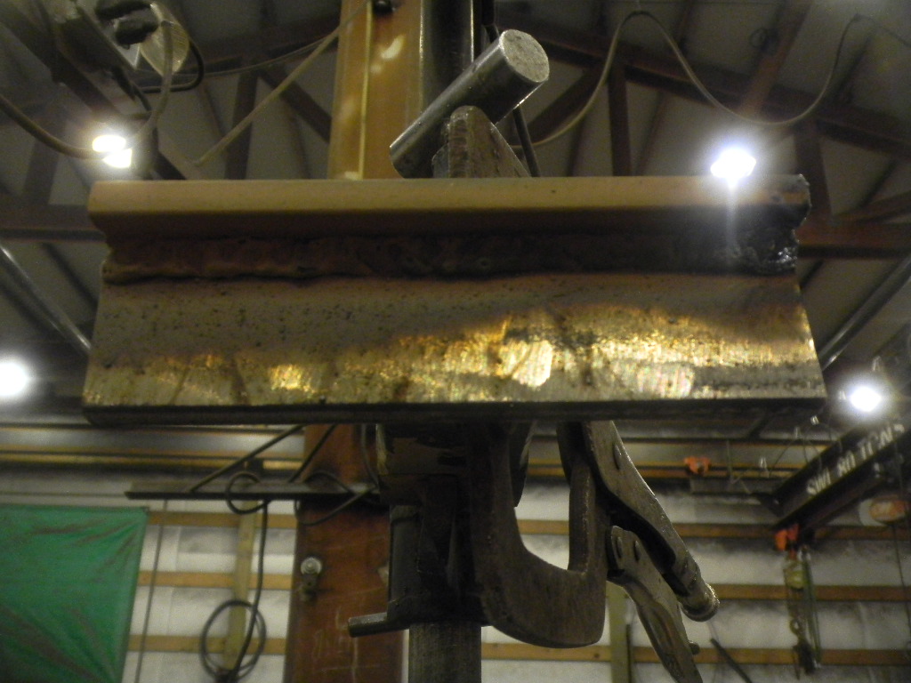

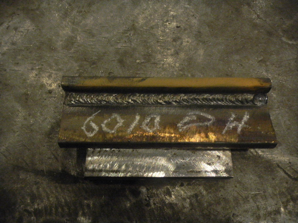

Here is an overhead weld I made with 5/32" 6010. Should have taken a little more time when cleaning the slag off:eek:. Now overhead with 6010, is like standing in a shower of sparks.:laughing:
