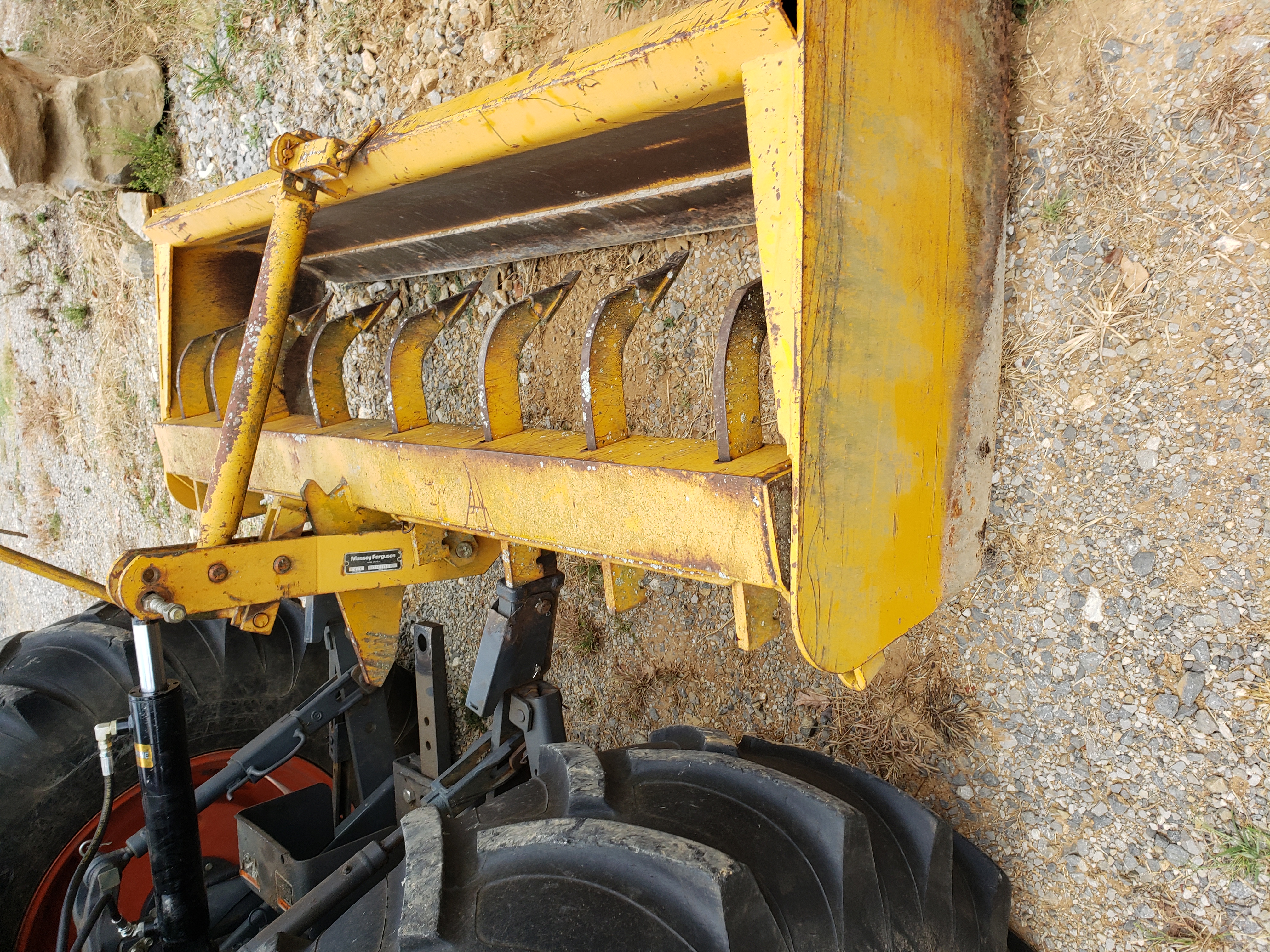

Bought a Massey Ferguson MF 18 box blade. It has ripers which come down somehow, and maybe its just has some rust and that's why its not coming down. Anyone ever work with one of these? The unlock bar moves easy enough, and the teeth start to go down but unable to get them all the way

Not sure if it's an optical illusion but looking at your first picture the right side loop looks bent outwards which might catch and not permit the rippers to roll down all the way.
   / How to operate a MF 18 box blade
Its an Illusion sort of. The first pic is before I start trying to lower it. The hooks do start to drop, going up/down many times, but never get them to go all the way down. Might just be rust, but would sure like to know how its should work

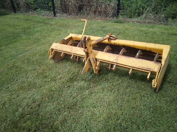

If seen those pics, and gee wiz I got a deal. They want 1500 for one without the teeth and I paid much less then that for one with all the teeth. :thumbsup:
   / How to operate a MF 18 box blade #7
Yeah, noticed that; now all you gotta do is figure out how it works. That's what I thought the extra pics might help. Seems to me like that part in between the toplink uprights is what latches the sorta pear-shaped piece either up or down, but I didn't see anything that'd actually MOVE the ripper beam. Maybe it was so cheap 'cause it's not all there? Dunno, but I'm rooting for ya... Steve
