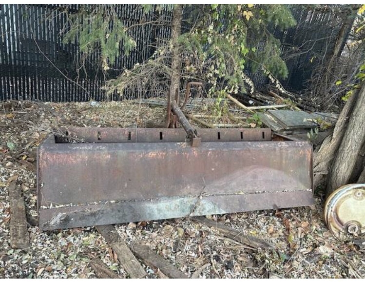

Thank you for the information. I will be ordering some new shanks and flat pins so I can put this beast to work.
   / How to operate a MF 18 box blade #14
@orangeiron Your Massey 18 box blade sure looks better than mine! They are far from quick hitch compatible. Stand clear when lowing the scarifiers it is dangerous how fast they swing down.
