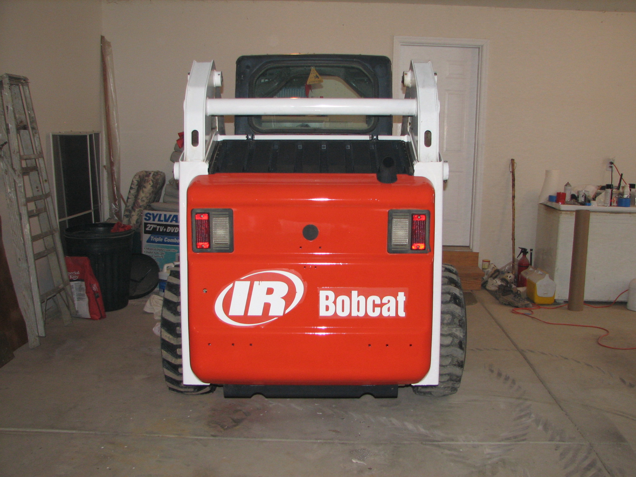

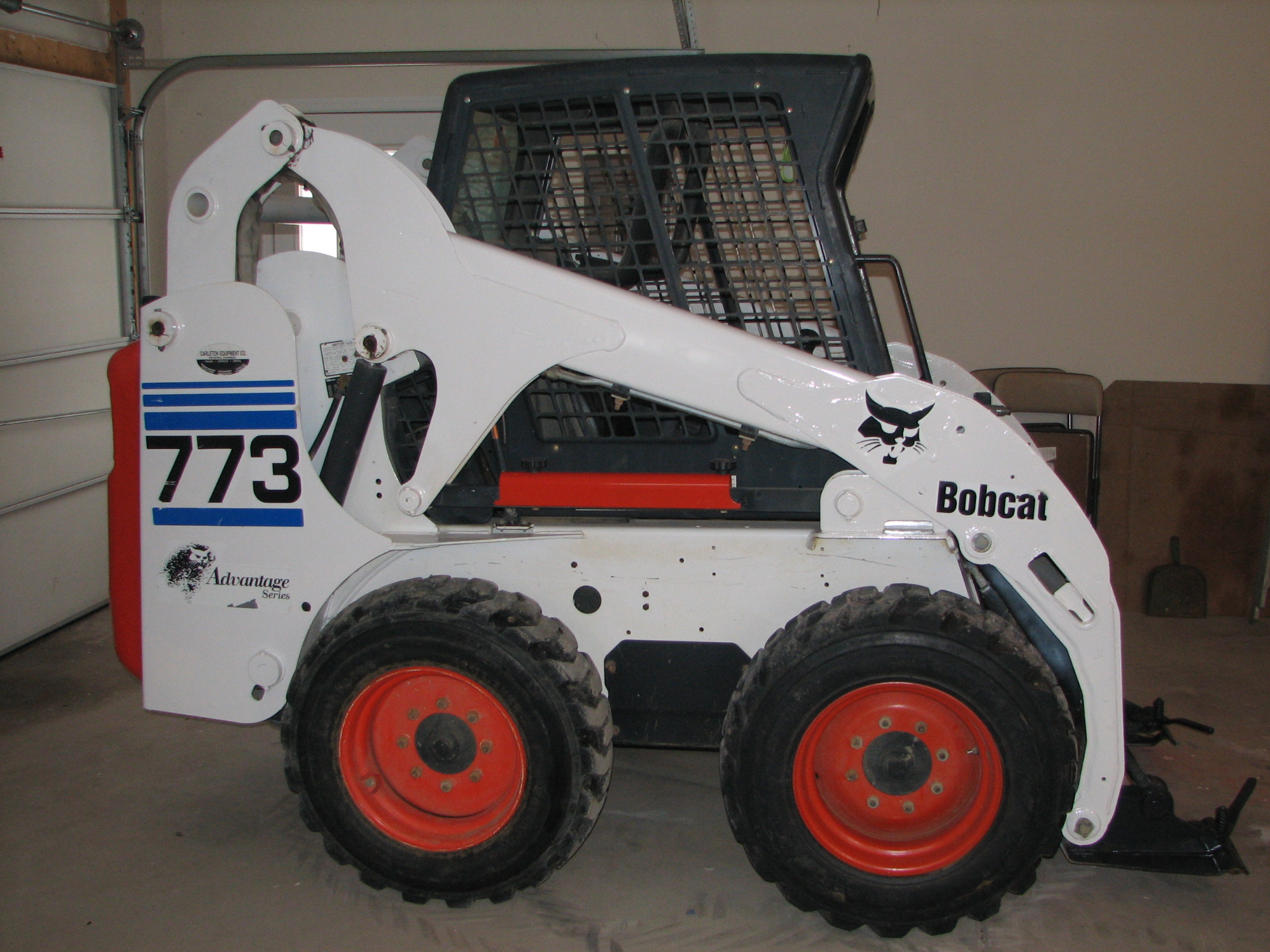

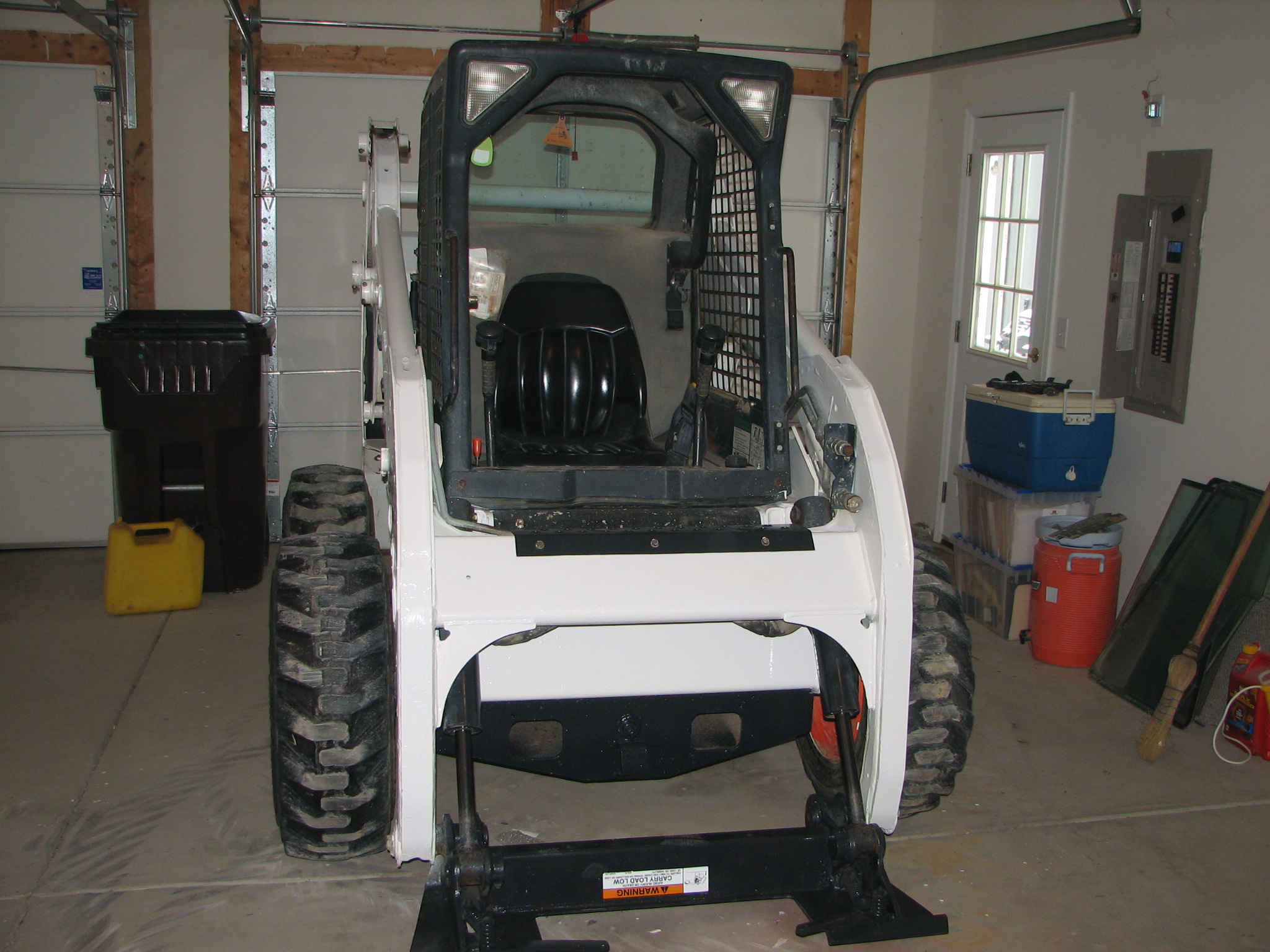

I finished touching up my Bobcat today. I thought I would post a couple of pictures. I used two products to remove grease, one called Aqua Kleen and another called Purple Power. I then used a grinder with wire brush and drill with wire brush to strip loose paint. Then I used a product called Rust Blast that etches and prepares metal to be primed with three coats of Rust Sealer. Finished off with several cans of Bobcat spray paint. Very happy with results. Thanks for all the advice I received.

Two cans of charcol, three cans of white, two cans of orange at $9 a piece. A quart of primer, Aqua clean, Rust Blast, a box of rubber gloves and 6 throw away brushes and plastic containers about $90. 2 gallons of Purple Power degreaser, masking tape & paper about $40. Two days of work plus trips to the store and a helper for three hours. Also $30 for kerosene heater to heat garage. of course there are supplies left over if ever needed again. Maybe my trailer next?

Very nice job. It really amazes me how well a bobcat skid steer can look with a little prep, primer and rattle can spray paint. I have done 2 and they really looked nice when done. In addition, the paint job you did will last a long time and the value of your skid steer went up considerably. The bobcat spray paint does a good a job of matching and is durable. I have only painted bobcat skid steers, but I feel the white color used by bobcat, maybe the easiest color to blend with existing color and give excellent results. Yes, you will get a few blemishes in the future, but they will be easy to touch up.
