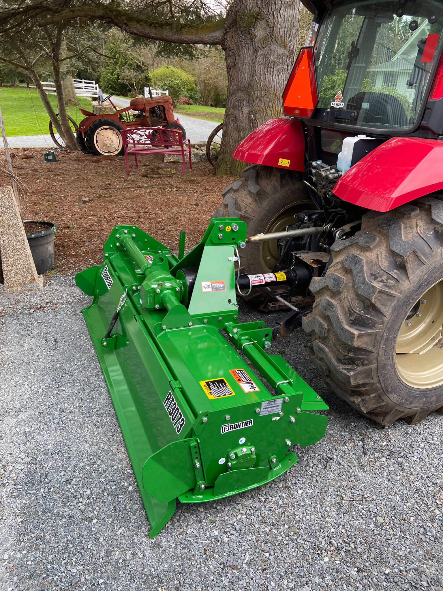

Thank you all for your input. I ended up buying a Frontier 3070 front rotation from my local JD dealer. The green doesn’t look too bad with the red tractor. A real stout looking machine at half the cost of some of the others I was looking at. I did learn how to measure and cut the PTO shaft from Everything Attachment video. I will search them for how to adjust the slip clutch. So much to learn. Hoping we will have a stretch of good weather this week so I can test it out. IMG_0740.JPGIMG_0740.JPG
