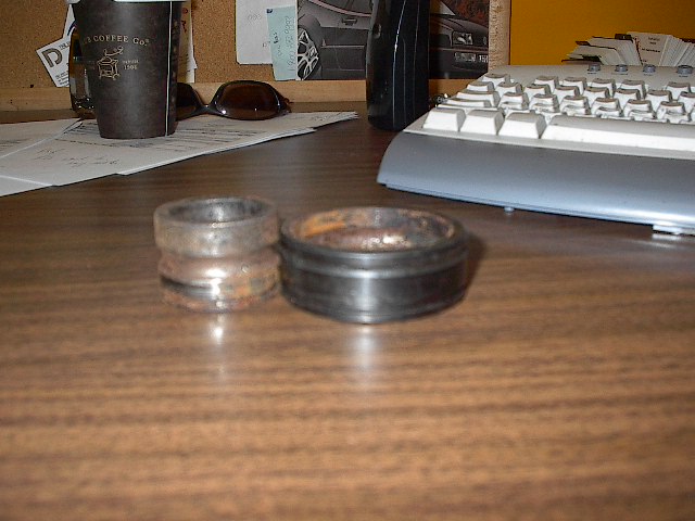

good luck... I had to remove a shaft bearing on the drive side of my flair a week ago... I was lucky, mine slipped off after only a few whacks with a chisel/hammer..
the bearing was completely shot, I'll be replacing both sides:eek:

Hey that looks familiar....
