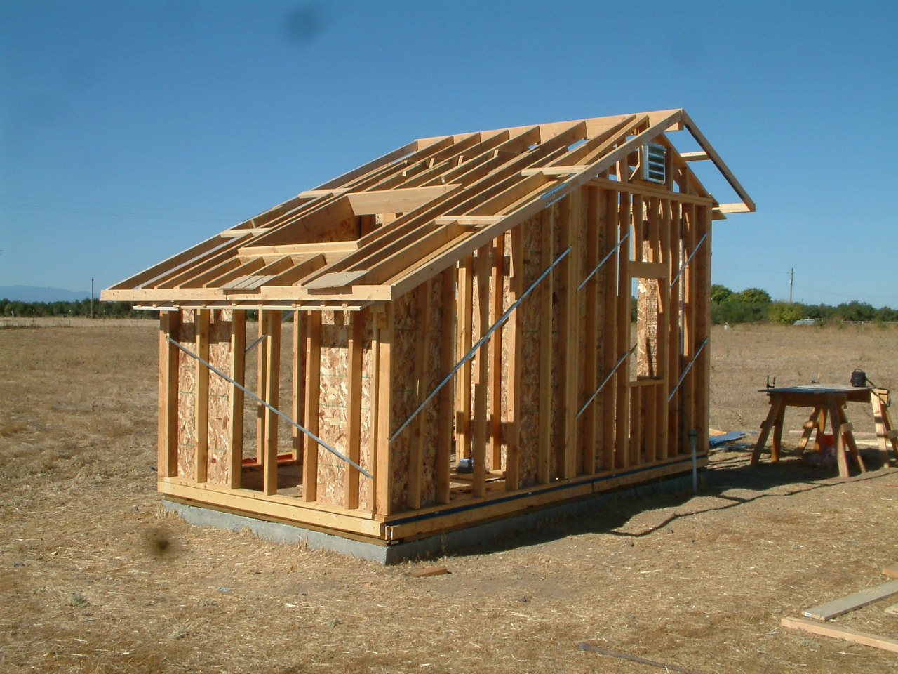

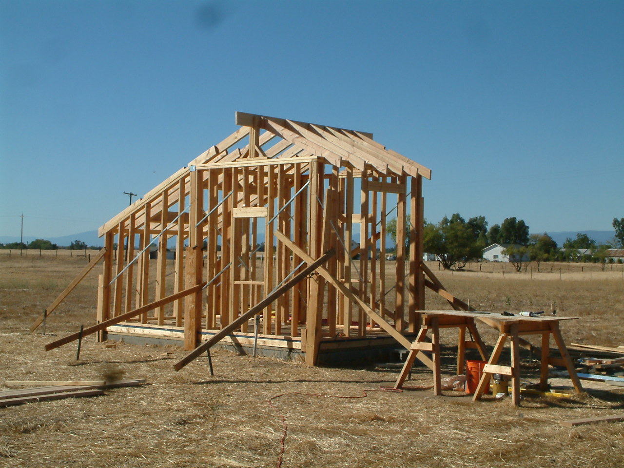

rlee6 said:
I am making a 8'x8'x8' tall pump house from 2 by 4's. I need help from experienced TBN'ers.
1) How do I join walls together at corners? (2"x4"x8' frame walls @2' center)
2) The roof will have a 2"x6" ridge and 2"x4" rafters. How do I actually fabricate it? Assemble everything on the ground and lift it at 4 corners? Or somehow fix the ridge beam first and nail rafters to it? I am clueless.
Thanks.
Here're a couple of photos of the frame for the shed I'm building now for my telescope.
The gable section is 8'x8' and has 8' tall walls.
I support the 2x8 ridge board for the roof with a pair of simple jigs made from a few pieces of 2x4. I think the photo shows how this is done. You have to come up with these tricks if you work alone like I do.
Add an extra 2x4 stud in the corner so you can nail the corners together.
Note the doubled 2x4 top plates on the walls. I like to use Simpson metal tie plates to reinforce the corner joints.
I like to use metal angle to brace the walls. Since it's windy up here in the North Valley, I nail some 7/16 OSB plywood to the studs in the corners to give the structure added shear strength.
The rafters are 2x6s, the rafter ridge board is a 2x8. The roof is framed with 2x4 barge rafters that connect to the 2x6 rafters with 2x4 lookouts.

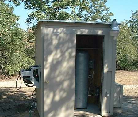

jinman said:
Jim, your wellhouse is almost a "dead ringer" for mine, including the flat roof. Some of my neighbors joked that it looks like an outhouse, but I don't care. It works great and the assembly was very easy.
Now if style is a consideration, the possibilities are endless. My well driller just suggested that the main part of the wellhouse not cover the well. I just put a little "doghouse" about 2' square around the wellhead with an opening into the main wellhouse. That way if the pump ever needs pulled, the main wellhouse can stay in place and only the little wellhead house will have to be moved. I even screwed it into place for easy removal. After 6 years, everything is fine.
Edit: Found a picture...
Haven't seen one done that way. Not bad. Around here the well houses are more 'pits' with only a few feet sticking up. The roofs are made removable to allow for pulling the well if needed.
