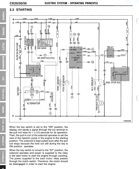

Just to be sure, the original problem is that the starter motor will not turn over correct? You hear a relay click, (probably the fuel relay and solenoid out on the fuel rack) but when the key is moved to the start position, the starter motor does not rotate.
   / How to raise loader arms on non-working tractor? #10
This may help. Of course the clutch switch could be at fault here too.
