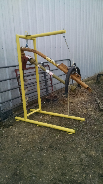

Came across this thread the other day and show what I created a few weeks ago.
What I like is if I need to move to PHD I can chain up to the loop at the top and move the whole thing elsewhere.

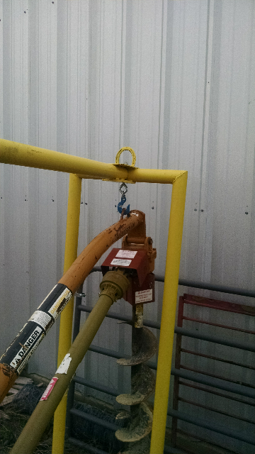

So I just bought a 3ph post hole digger/auger from TSC. Haven't messed with it as of yet.. tomorrow probably. So once I get it on there, how do I go about taking it off and parking it while making it reasonably easy to re hook up? Brushhogs, discs ect just sit there till next time.. this I dont believe will stay upright till next use. do you guys build some sort of rack to set it on , or just what do you do? Dig a hole and leave the auger partially in the ground to stabilize it? Seems that would be detrimental to the well being of the auger. So before I go out and play with it tomorrow... give me a game plan please.:D

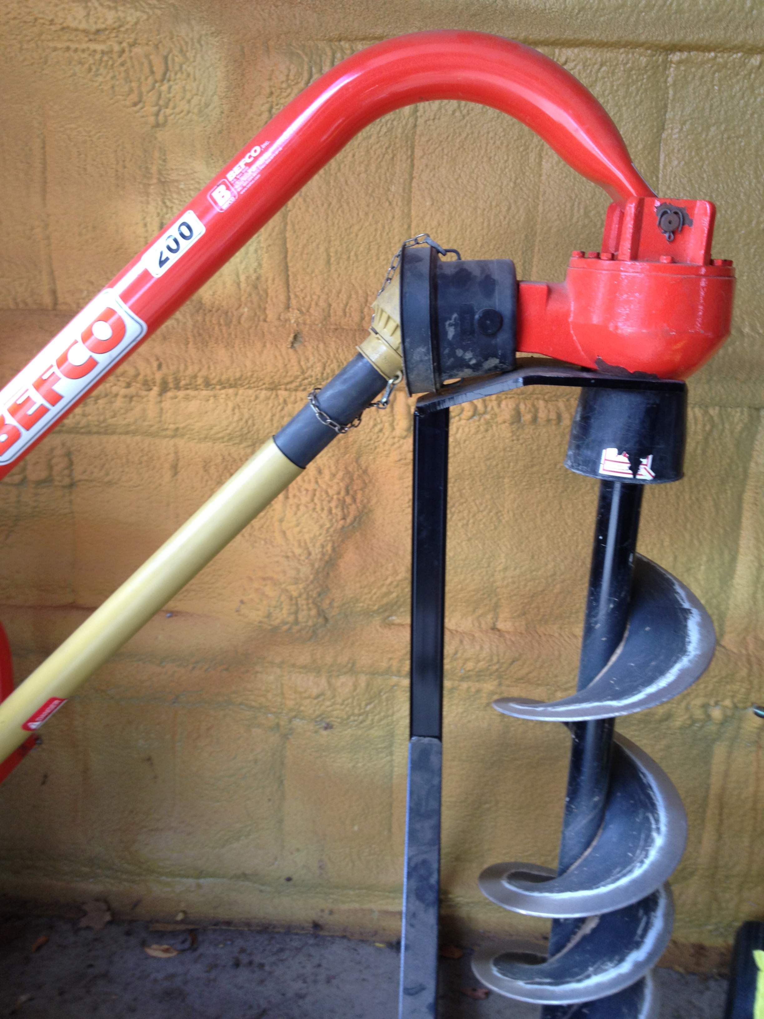

Had a stand made for mine.
