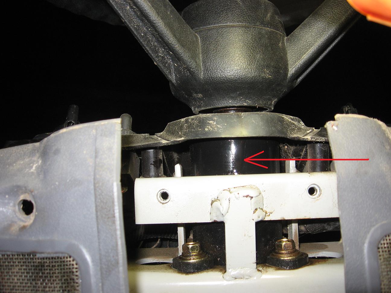

Can someone give me step by step instructions to fix this leak. Thanks

It is hard to tell where it is leaking from. Have you tighten the connection? Is it leaking from the steering valve ,connection or the hose? When you turn the steering wheel with the tractor running can you see where it is leaking? Be careful it is under high pressure.

Thanks for the reply. It's dark out here and I didnt check well and assumed that it was the fitting. But it is not the fitting and when I turn the wheel I cant actuall see the oil coming out of anywhere but the neck has oil beed of oil coming down it. I'm not sure how to proceed to check any further. Any help would be great.

I currently have the same leak and have just ordered a seal kit for the steering unit. It might be a few weeks before I get a chance to tear it apart, but I'll let you know how it goes. From the amount of grime insde my panels, it has been leaking for a long time, but I have never added any fluid to it.

It looks like it may be coming from the seal around the steering wheel shaft. It should be OK to use if it is a slow weep. If it is coming from around the steering shaft then it would be to reseal the steering box. I guess I will have to quit using my steering wheel for a grab handle.

It looks like the leak must either coming from the crimped fitting(s) on the end(s) of the hose(s), or else from the steering unit itself, called the "steering orbit roll" in the service manual, and the "steering controller" in the parts book (part# 4265075M92). The service manual description of removing the controller sounds fairly straightforward, but-- perhaps you could begin by having the hoses checked at a hydraulics shop? (I'd bet on the hose fittings.) It looks as though the steering controller is a non-fixable item.
