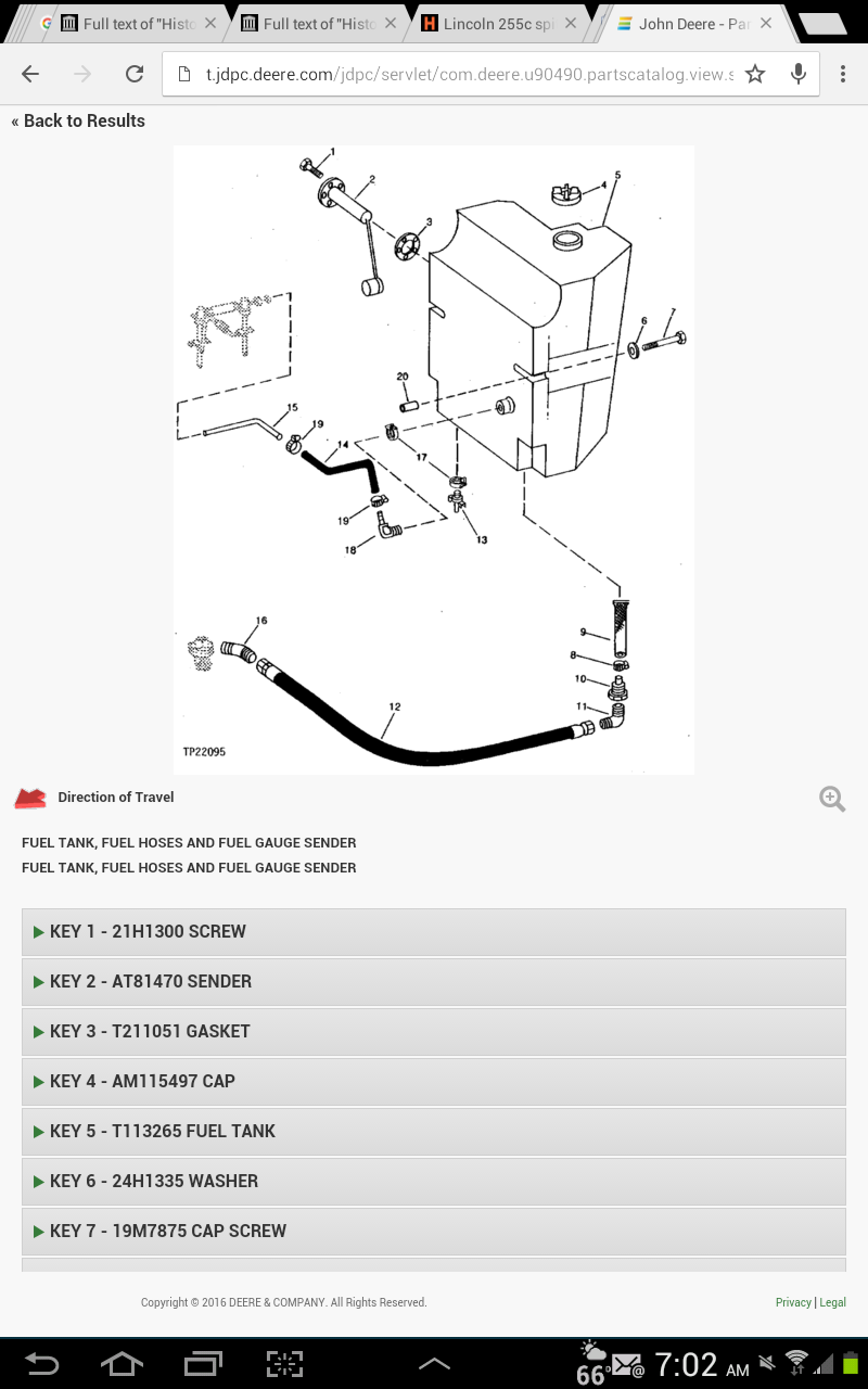

Hello, recently purchased a John Deere 310C backhoe. Last week the flexible fuel line from the fuel tank to the pump started leaking at the tank or the fitting on the bottom of the tank. Anyway, that is where the fuel is leaking from and running toward the pump to a low place in the hose. Then drips onto the ground. Have tried to feel a clamp but don't feel one. Went on line to look at a manual, but the picture was so poor it was useless.:( Any information about this will be greatly appreciated, and thanks in advance.

Shot of parts book attached. It appears to be threaded to elbow. May have to loosen and lift tank to get access. I don't remember how the tank is placed though.

Really appreciate the picture, it is so much better than the one I located on line. Now I have an idea what I am dealing with. Thanks Again:thumbsup:
