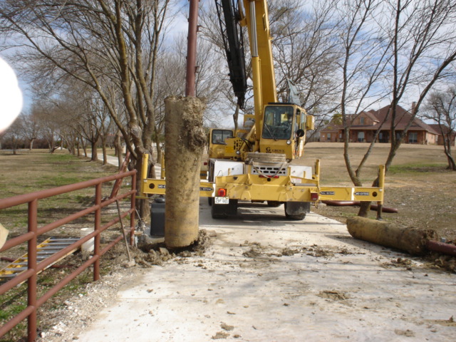

I've had to remove gate posts that have been damaged. Here's one that will make you appreciate what you're facing.
