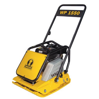

I have a project that will take most of next summer and I would need to rent a compactor two or three times at $230 - $275 per week. I spent a few months on Craig's list and found a Wacker 1550 in great shape for sale and paid $650 for it. After buying it I contacted several landscapers and pool companies and found one who agreed to buy it from me for $500 when I'm through. Now I have a machine at my disposal when I need it. Luck was definitely involved
The same thing might work for you.

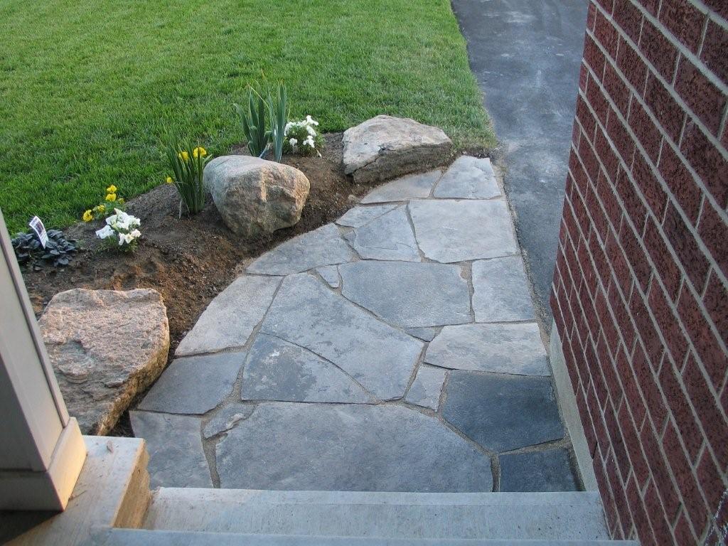

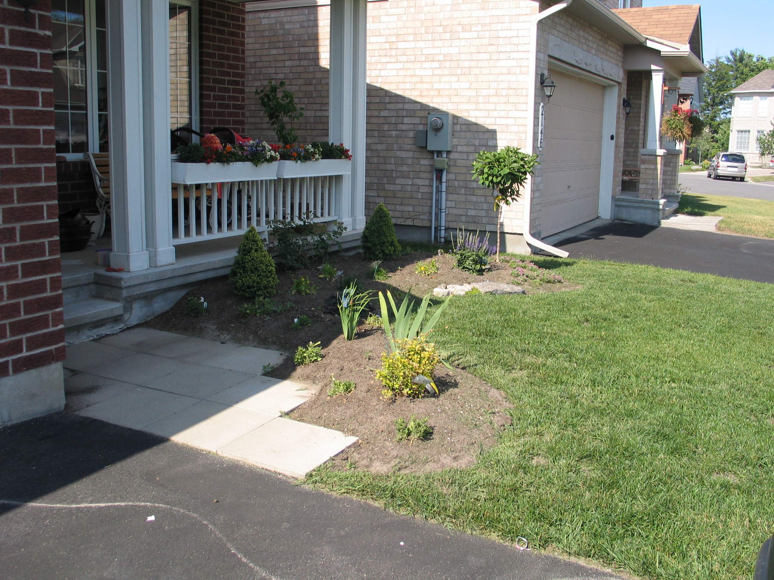

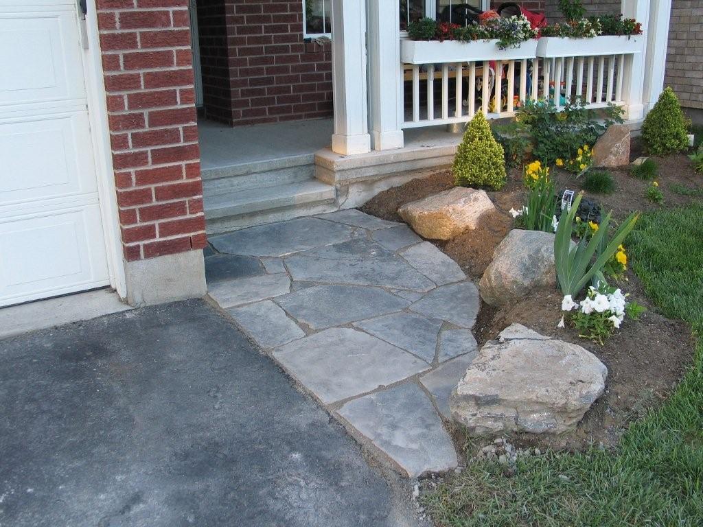

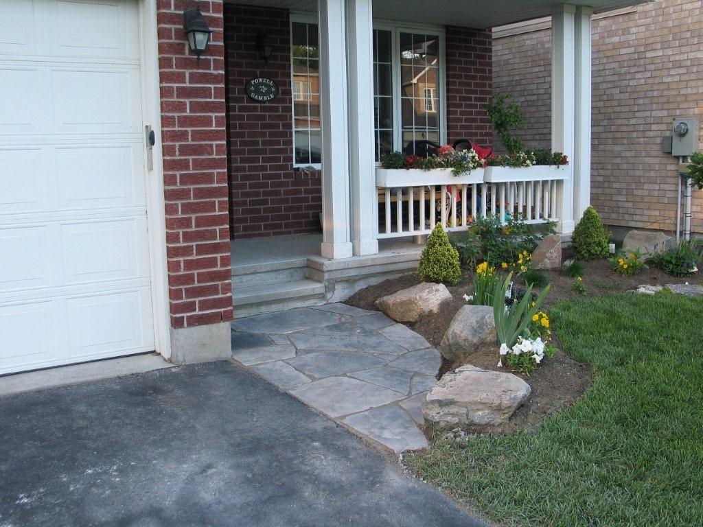

Typically you DO NOT vibrate flag stone. Depending on the thickness and size, most likely you'll crack it. Tamping is meant for small pavers that you set "high", then compact to grade. You use the vibrator to help get the sand between the joints, since in the case of pavers the joints are so small.
Here are some pictures of a small flag stone path that I helped a friend do. We used polymeric sand for the joints. All I did was hand push it into the joints (with a dowel or brick mortar tool), sweep it off the stone! (or it will stain it), then wet per directions. Make sure you purchase polymeric sand intended for larger joints and you should be all set.
Forgot to add - I'm in Ottawa Canada, the walkway has stood up to a few winters without any problems. So as long as you have a good base and follow the directions on using the polymeric sand I think you should be good.
