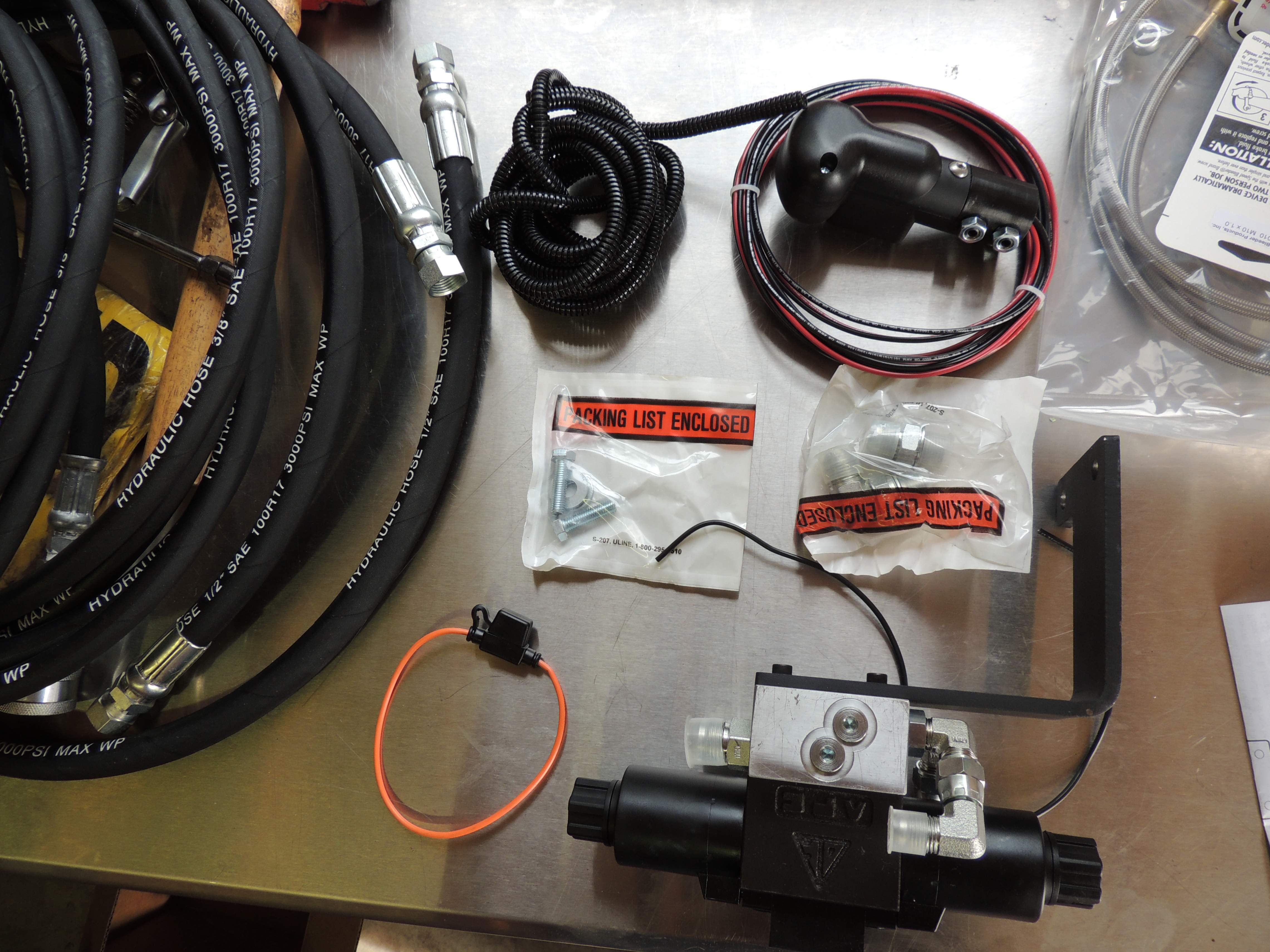

Here is the kit:
Started installing it today and have already ran into 2 problems.

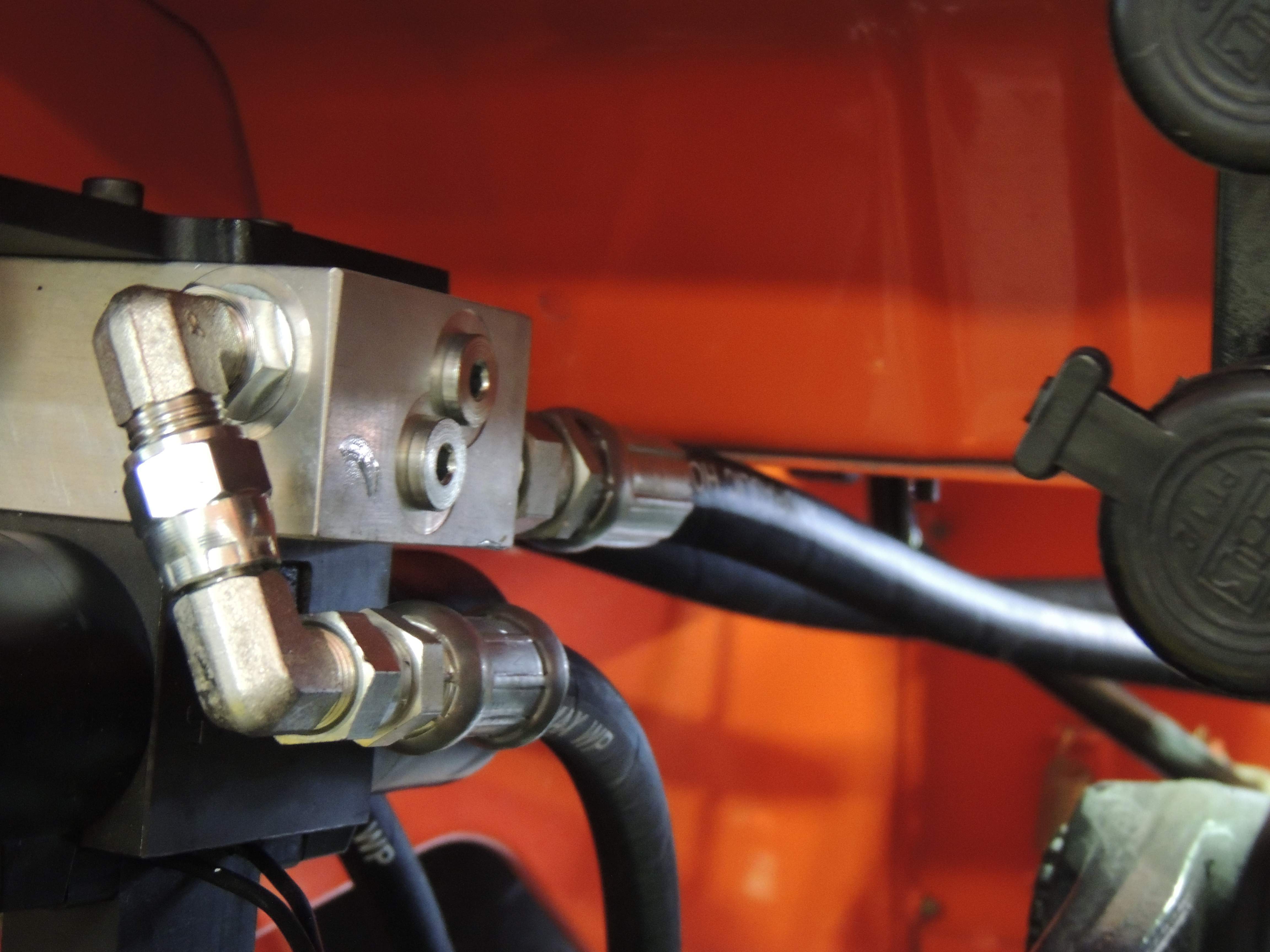

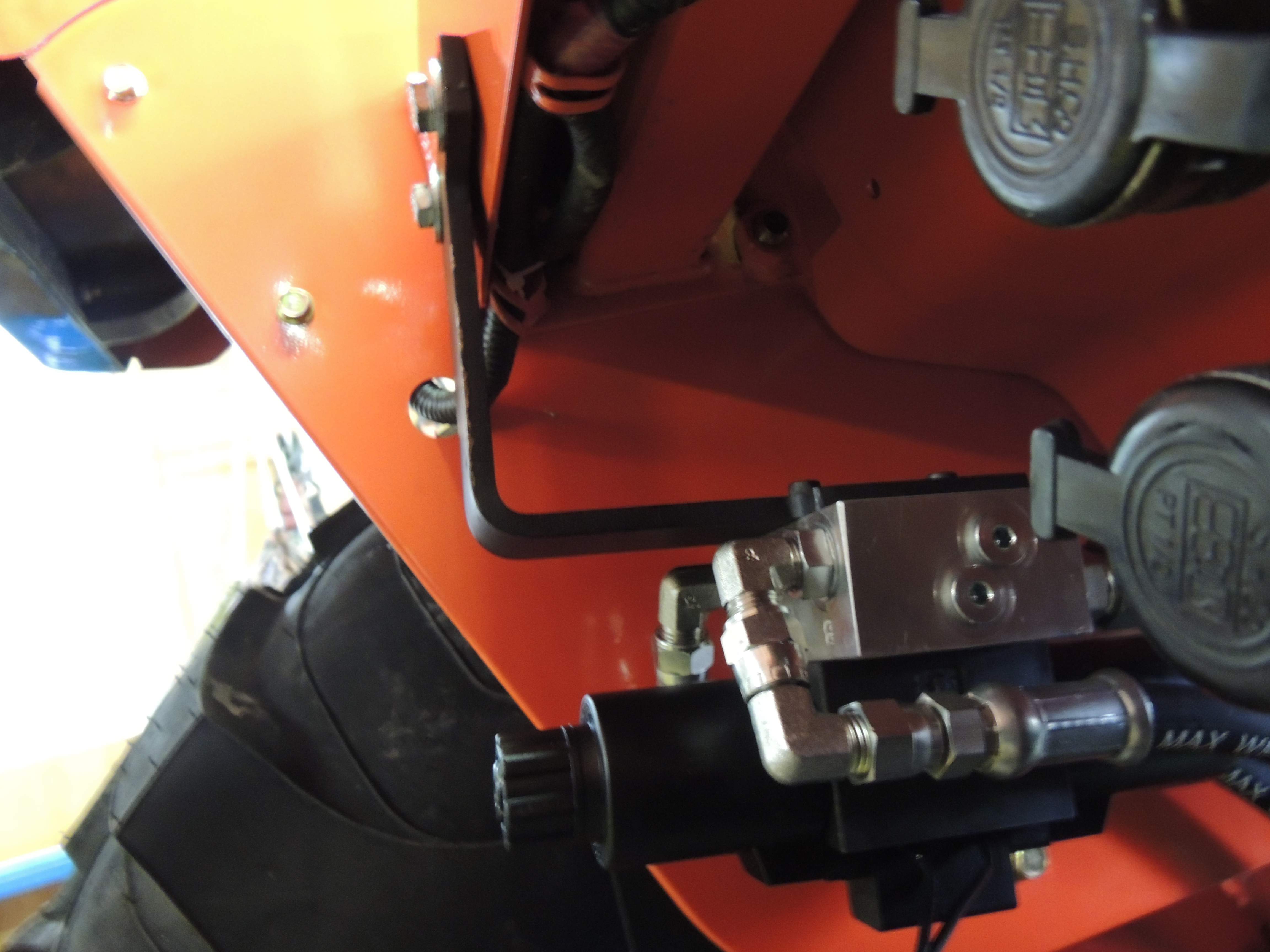

1) The bracket with the 3rd function valve on it doesn't seem to be correct, seems it doesn't have enough drop to it causing the 1/2 lines to hit the underbody of the tractor.
You can see there is no way I would have had room to get those lines on if I mounted the valve first. You can see the bracket isn't flush with the rear mounting surface of the tractor.
I put the hoses on the valve first given there isn't much room in there to get a wrench on the hoses once you mount the valve.

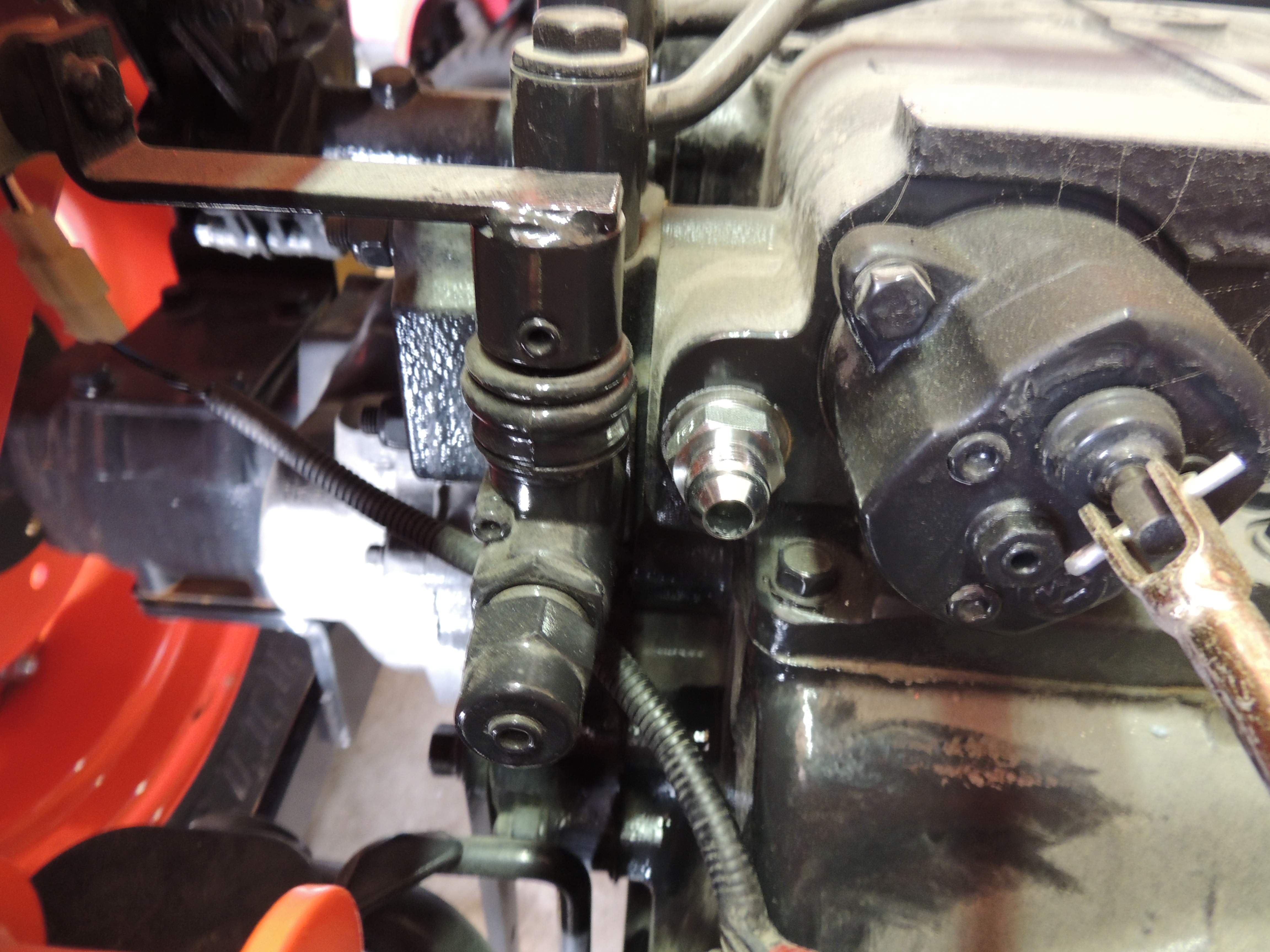

2) Not sure how to get the current handle off the control lever for the FEL, seems to be glued on or something, no screw to loosen and I tried just unscrewing the handle thinking it may be threaded. No luck. Anyone know how those handles are mounted on there?

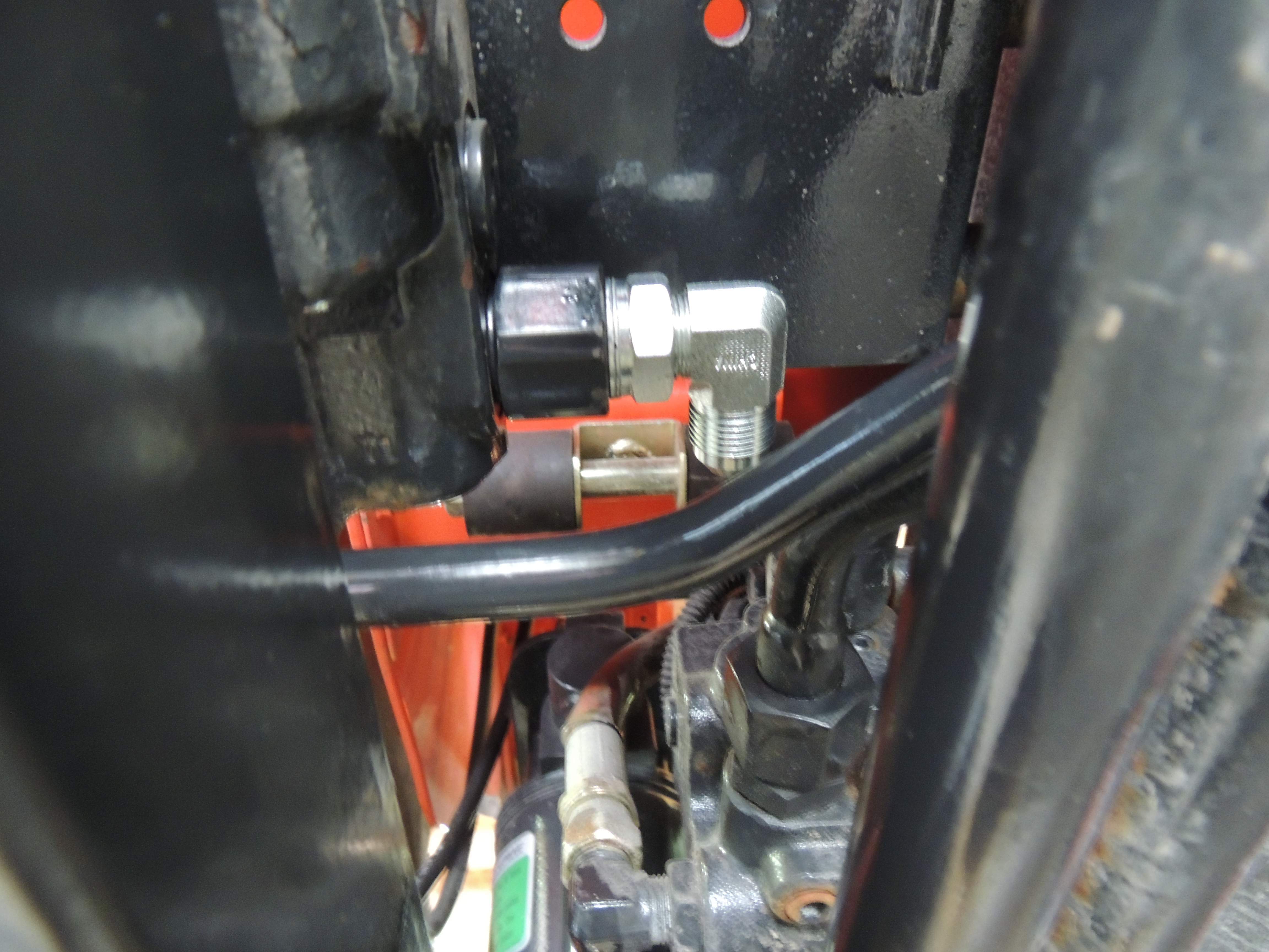

What I thought would be the hardest part, getting the old solid line off and new lines on the loader vavle was actually pretty easy. Here is the 90 degree adapter they give you mounted to the loader valve.
Here is the adapter on the rear hydro unit (this is where the power beyond line went).
These two pictures explain exactly what I wasn't sure of, thanks!

OK , I got the bracket and valve mounted but the hoses are up against that underneath part of the tractor fender, so taking a run to Home Depot. Thought is I will use some foam wrap like you use to insulate pipes around the hoses to stop them from rubbing.
I dont think the handle on the FEL lever comes off, the new handle is actually longer, so I think I will be cutting off the old one.
