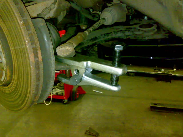

#29
There are a few tricks you can try to separate the tie rod end. You can loosen the nut and then use a floor jack on the nut and lift the front of the tractor up a little and then give the metal the tie rod goes through a whack with a hammer. This usually works well. But advise is to buy a tie rod/ ball joint separator. You could buy a HF one but I would spend a little more and get a higher quality one. I have this one, made by OTC (not my picture though). Most HF tools with threads seam to strip out or get damaged in other ways for me. But the OTC one has handled even the 1/2" impact with no problems.
I see this tool online for about $50. It will work on an L3800 you think? I will probably go this route...
   / How to separate front tire knuckle to replace dust boot? L3800 #30
I'll go try it on my tractor and take a picture.
