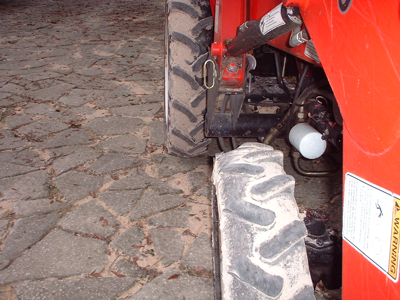

My front (ag) tires are shot. But the wear clearly shows that they are shot on the outside edge, whereas the inside edges are only HALF as worn. They both look tilted out at the top of the wheel. (as seen from the front of the tractor)

OK check out the wear. You still think I should flip these tires to even out the wear? Or are they too far shot. I know if these were car tires, they would be gone, but how much utility do I have left here?
